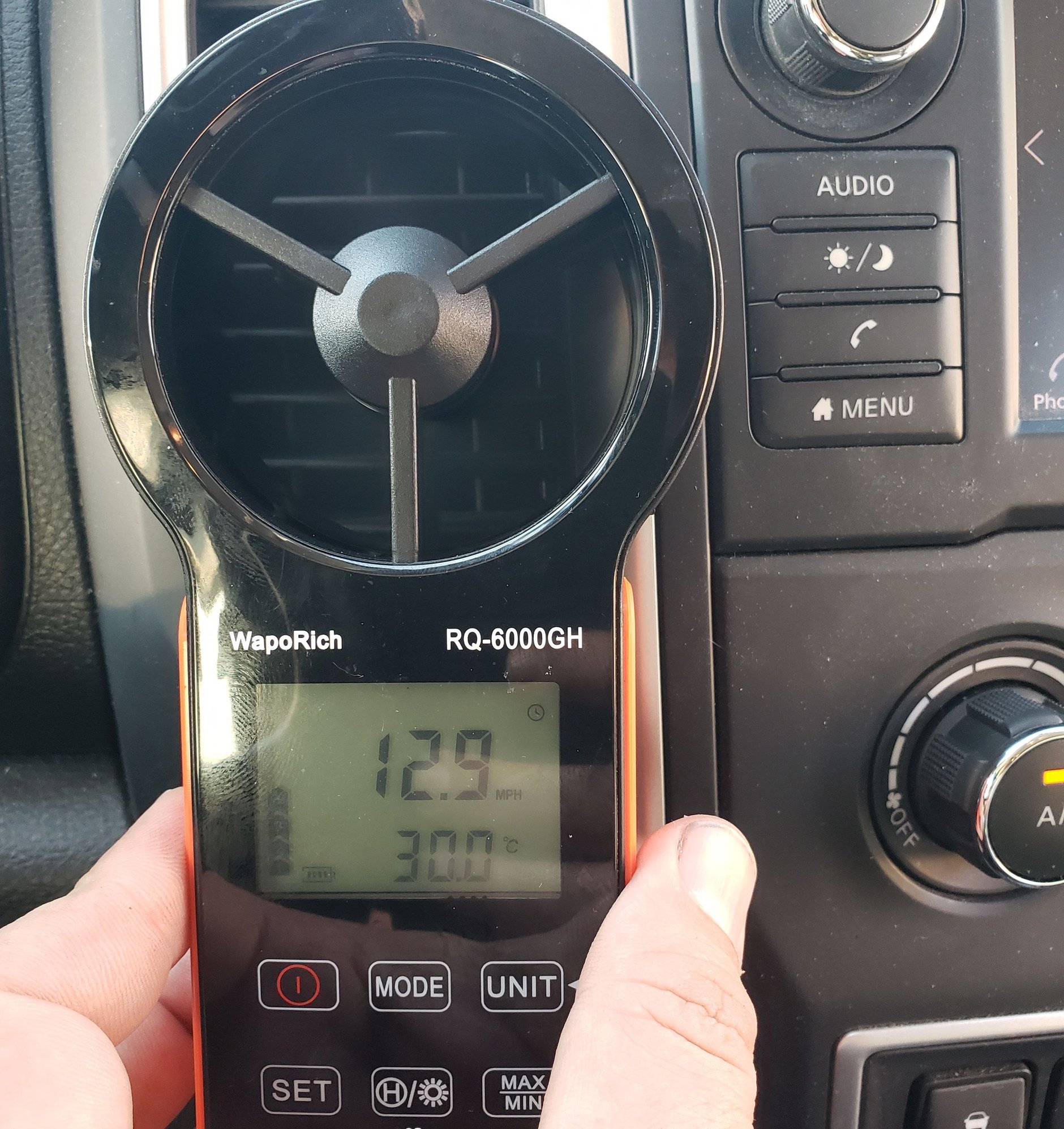

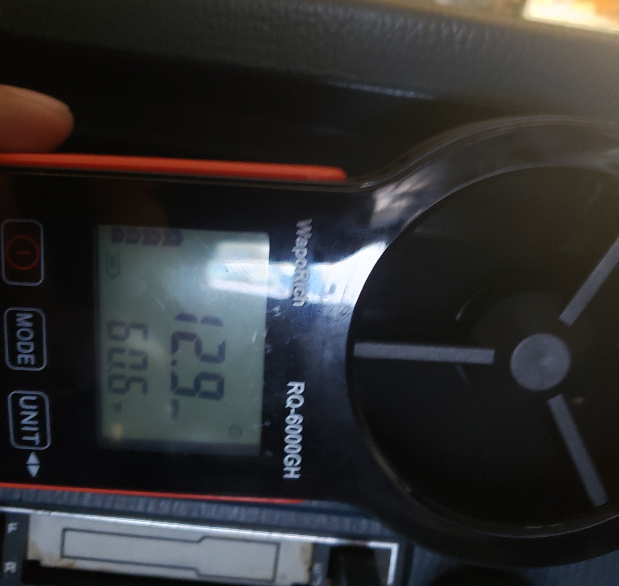

The fact it is all inside the vehicle requires it be much more compact than the GM setups. Smaller evaporator core and smaller heater core which reduces their BTU capacity. The ducting itself also becomes smaller. I would be interested to see the BTU capacity on the largest VA unit. I am sure it is considerably less than the GM unit and the CFM is definitely far less. VA5 unit in that C10 blew like a reconditioned factory C10 setup did on the 2nd blower speed notch. The GM setup blew like a hurricane on high in comparison.
I kept hearing people complain about how poorly GM AC systems of this era blow. I took an anemometer and made a comparison between the 1987 G20 van I have and both my 2011 Pathfinder and 2019 Titan that also have fantastic AC systems. The G20 van did not have any less blow than either Nissan product from the vents. They all read in the 12-14 mph range on high fan speed with the Pathfinder actually blowing the lowest speed. The F-cars have the same blower motor as the van so it is definitely not a weak blower motor issue. It is the evaporator cores being choked with 30+ years of debris. In my test the GM actually blew the hardest before the AD244 alternators voltage regulator temperature compensation cut back the charging voltage back to 13V from about 14V on a "cold" start.
1987 GM at hot idle. It reached nearly 15 mph with 14V on the electrical system which helps the initial cool down quite a bit.
2019 Titan. This truck has a brushless PWM blower motor that runs at the same RPM regardless of system voltage. Flat line fan speed at just under 13 mph.

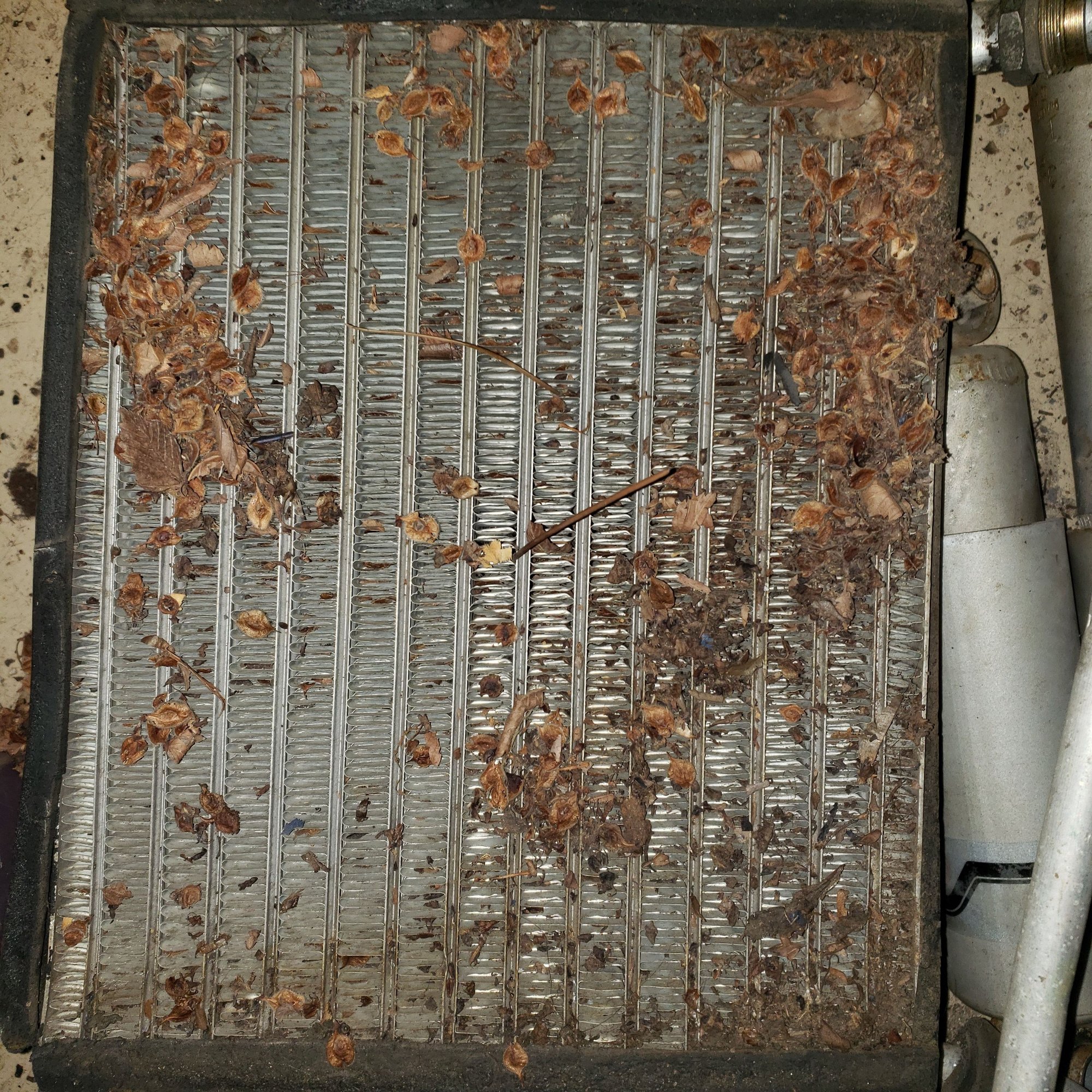

Here is 30+ years of garbage in a GM evaporator core. This one only had 104K miles when I tore it apart. The HVAC case was packed half full of the same rotting mess as well.
HVAC case from the blower resistor opening prior to opening it up. Evaporator core was half covered.
