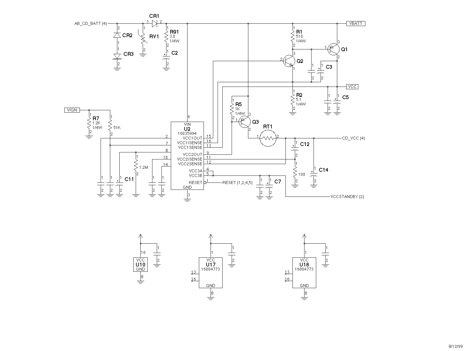

I have a 92 Camaro 305 tbi with a 1228746 ecm. Yesterday I had a bunch of symptoms that pointed to a bad ecm. Cracked it open and found capacitor "C14" to be bad. It has continuity and does not increase resistance to infinity when tested with a multimeter (tested with one leg disconnected). If possible I'd like to just replace this capacitor but I can't find any information on it, the codes on it seem to be internal GM stuff or something. Can anyone tell me what the capacitance would be or point me in the right direction to search further? Thanks!

Capacitance: The code "7152" typically indicates a capacitance value in picofarads (pF),
7.15nF
7.15nF
or
7100pF
7100pF
depending on the manufacturer's specific coding convention.

Murata DEHR33D152KA3B should probably work.Also, the capacitor in your photo looks thermally damaged, so inspect nearby parts—especially:
  • driver transistors
  • flyback diodes
  • ignition/injector drivers

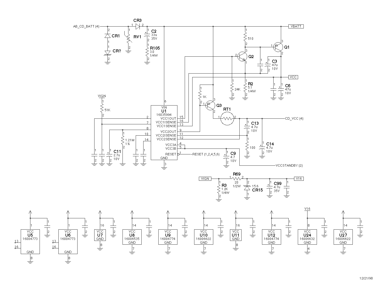

Actually I'm fairly certain I just found it. I reverse image searched that diagram you sent and my exact ECU doesn't have the capacitance listed but the ECU right above it has a practically identical circuit with the C14 capacitance listed. Thanks, I never won have found that website otherwise.

4.7U 10v ?
Old Apr 22, 2026 | 10:48 PM
Lost_Arts's Avatar
Joined: Apr 2026
Posts: 9
Re: ECM capacitor identification pls 👉👈
Yep
