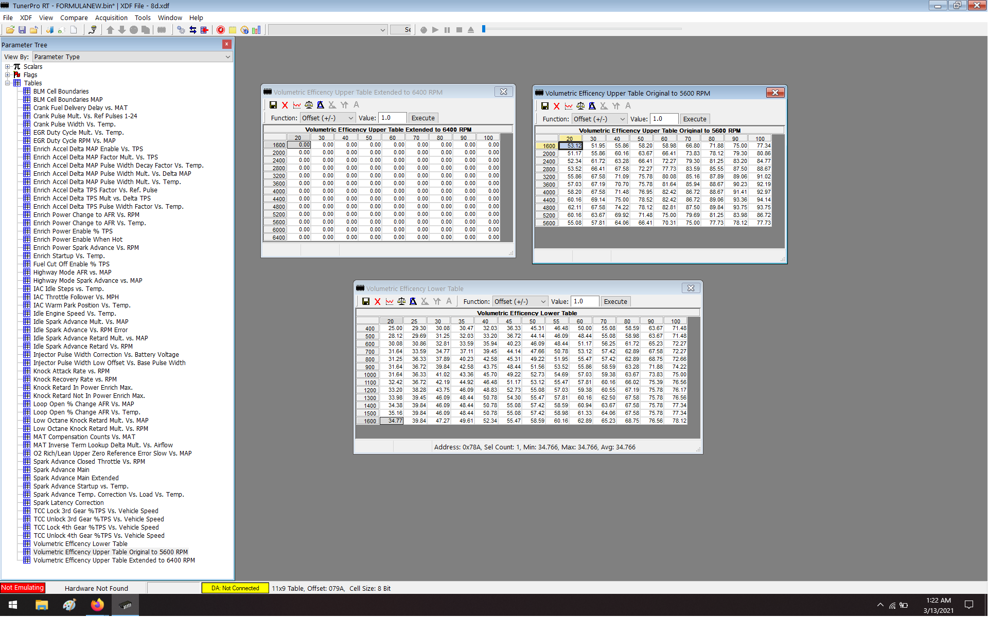

Looking at the VE Extened upper RPM tables. All are blank?!!?
I am guessing because of what i am using perhaps? Here are all the files, XDF etc i am using. Just weird because the lower tables don't even match the original upper tables let alone the zero'd new upper/upper tables.
Also, i was (JUST LOOKING) at advance spark and seen some 40*+ areas, kind of worried me some... If you think i need to dial them down i can. She has a 160* Thermostat, fans on at 170* and 9.6:1 Compression (ALWAYS) 93+ Octane (NO LESS) Not even 91 !!!! Also seen a AFR table at 15-16:1, VS KPA... I can dial them down to 14.7:1 MAX if needed also.

Are you using super aujp xdf to look at a $8d non saujp binary file ?

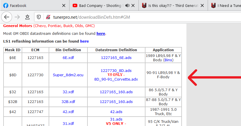

Tuner pro.net has the ads to convert to adx or gearhead efi has it too

This is all i can find on tuner pro... The ecu file is super 8d, and i cannot use the vette adx because wasn't the vette a 6 speed?

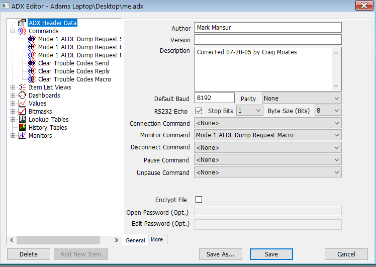

I tried the whole "CONVERTING .ADS to .ADX, but i am not getting the proper menu under the "COMMANDS" tab.
This is what mine shows. Doesn't matter which i try ot use, i am still getting that "UPPER V.E" that is blank across the board, as if it was wrote on it like that?!?
Going by Maotes conversion "HOW TO"... Only one that looks like that listed under "COMMANDS" is ALDL DUMP REQUEST REPLY.. I changed the 66 to 67 in that one, it is identical just named different. Still doesn't change anything, on that VE table that is.
http://support.moates.net/tprtv5-ads-to-adx/

my attachments aren't working on my slow satellite internet. your tune is not s_aujp based but aujp $8d based. edit using the $8d xdf

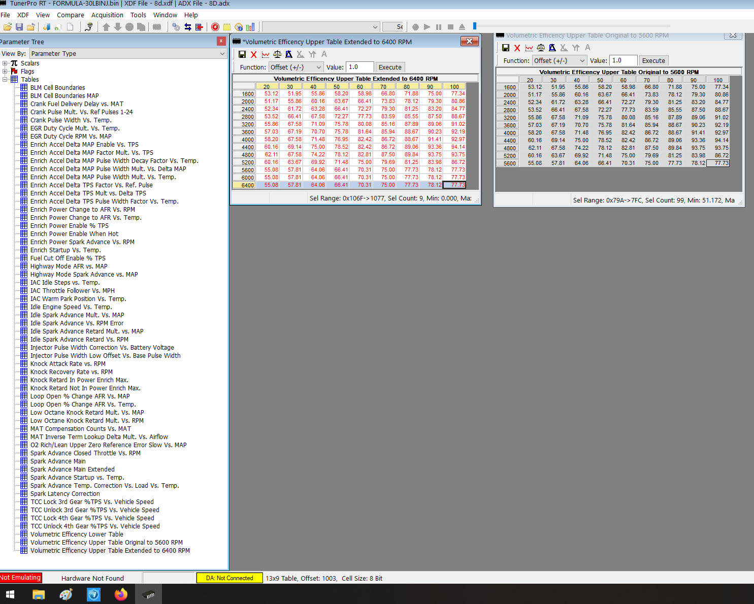

Here is the link to the stuff i am using currently: https://www.mediafire.com/file/da555...1h/8D.zip/file
Using those files, the upper VE table is still showing all zeros which makes me think it was programmed that way. Maybe the computer doesn't look at VE at those upper RPMs.. I just went ahead and copied/pasted all the original tables into it, and used the last line info across to fill up the last 2 rows...
All i know to do.

Extended ve is a different code patch

Your viewing the bin wrong

Not sure if this will work or not, but this is what I used...

Looks (A LOT) different but more factory, THANK YOU! Just what i needed!

Thank You for this.. I did a burn based off the original bin and modified the injector rate. Smooth as a baby.
