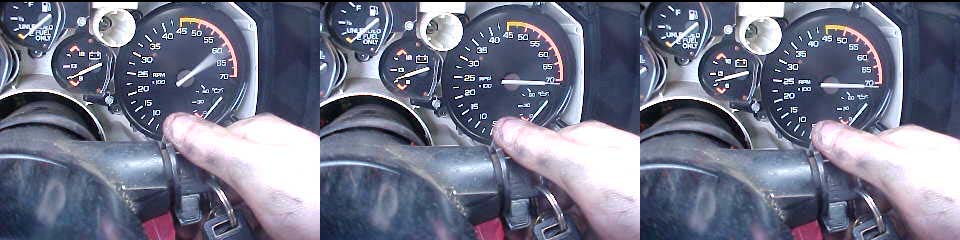

this is whats happening #1.....

forgot the pic
Old Apr 24, 2004 | 04:43 PM
stevecvash's Avatar
Joined: Dec 2003
Posts: 49
From: GA
Car: 85' Camaro Sport Coupe
Engine: 1970 LT1
Transmission: 700-R4
Axle/Gears: 3.23 Posi
the engine is starting to turn over

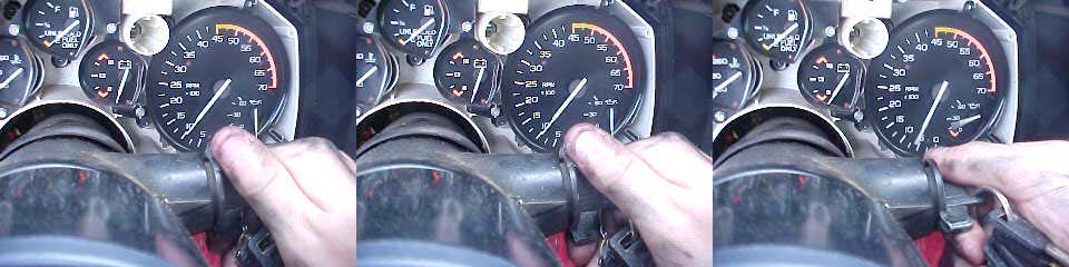

Old Apr 24, 2004 | 04:46 PM
stevecvash's Avatar
Joined: Dec 2003
Posts: 49
From: GA
Engine: 1970 LT1
justed started and running in the last one

Old Apr 25, 2004 | 09:19 PM
ss85tadude's Avatar
Joined: Oct 2003
Posts: 528
From: NorthEast GA
Car: 85 Trans Am
lol Why are your pics triple like that?
Yeah you probably have a wiring problem somewhere.
