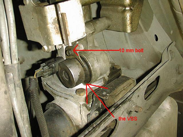

Originally posted by GreyFox
what is considered a highway trip because i run for work about 26 to one store and if i have to go out to the other one its 50 mi, and after i disconnected it my spedo still worked
you unplugged the plug from the trans that looks like this one?
or did you unplug the other one?
why the heck do you want to drive without it connected anyway?

i unhooked that one in the pic, becase there is something wrong with the system, irratic engine speed while driving, it would constantly lock and unlock while at any speed sustaind, accelrating or slowing, unhooked it for diagnose and it was that, now i have to trace out which component it is, hopefully its the TPS, is that a common part to go out on that system??

well i believe it was that one, as long as that plug has the four wires on it which i believe it does

nope.
it has two.
the 4 wire connector is on the front of the trans and is the power for the TCC lockup.
the pic i showed is the VSS. its two wires... yellow and red.

ohh ok casue the four wire one is what i disconnected and then my problem went away, either way from my understanding they work together in the tcc lock up along with the TPS and i believe in that group is where my problem is

What you disconnected was the wires for the TCC solenoid.
