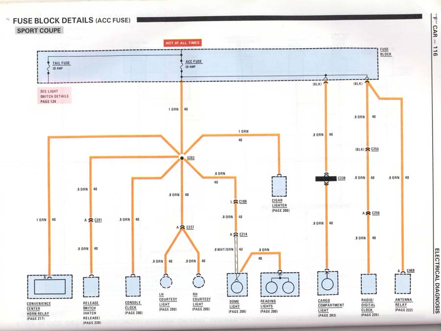

Old Jul 22, 2004 | 08:23 PM
Trickster's Avatar
Posts: 6,127
Likes: 12
From: conway, s.c.
Car: 1989 Iroc-Z
Engine: 5.7L TPI
Here you go, this should help you in tracking down your problem. Have fun!!!!!!!
