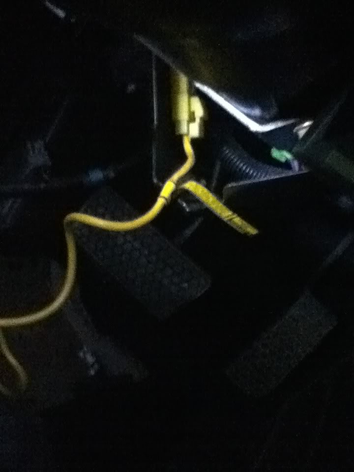

there are several unplugged wires under my dash, im trying to find out what they are, one has a vacuum line on it and one under the steering wheel is simply cut, i think the cut one is for the air bag. please help im trying everything to get this car running and im sure all this stuff unplugged is not helping.

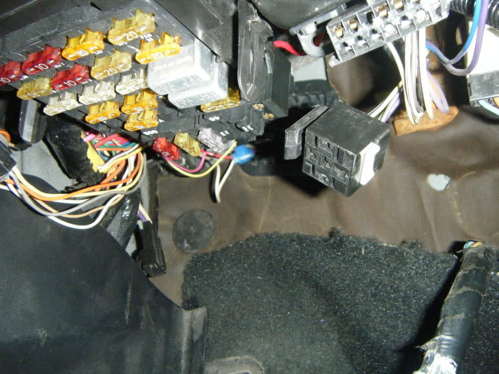

this is where the first pic wire comes from, behind the brake under the carpet.
this one is to the left of the brake pedal coming over the plastic

Yellow is airbag

ok, here are some clearer pictures. i figured the yellow was airbag, that wont effect running will it? i doubt it.

here is blue wire with vacuum line

2 unplugged in this one, the one way in the back to.

Yellow mean airbag. Connectors, tape, anything yellow, dont mess with. No, it wont prevent the car from running
The harness with the large vacuum hose is cruise. Look over the top of the column for the mate. Hose connects to the right side brake switch on the barb
Large square is a relay socket for some option you dont have. Theres on in the camaro RS in my garage too going nowhere
2 row connector bolted to the fuseblock is the ALDL. Hook your scan tool up to this or use a paperclip to ground out two pins to pull the trouble codes if the MIL comes on
2 pin Yel/PPl connector in the back is an inline connector for the clutch safety switch on manual cars. Yours is auto so dont worry about this one either
