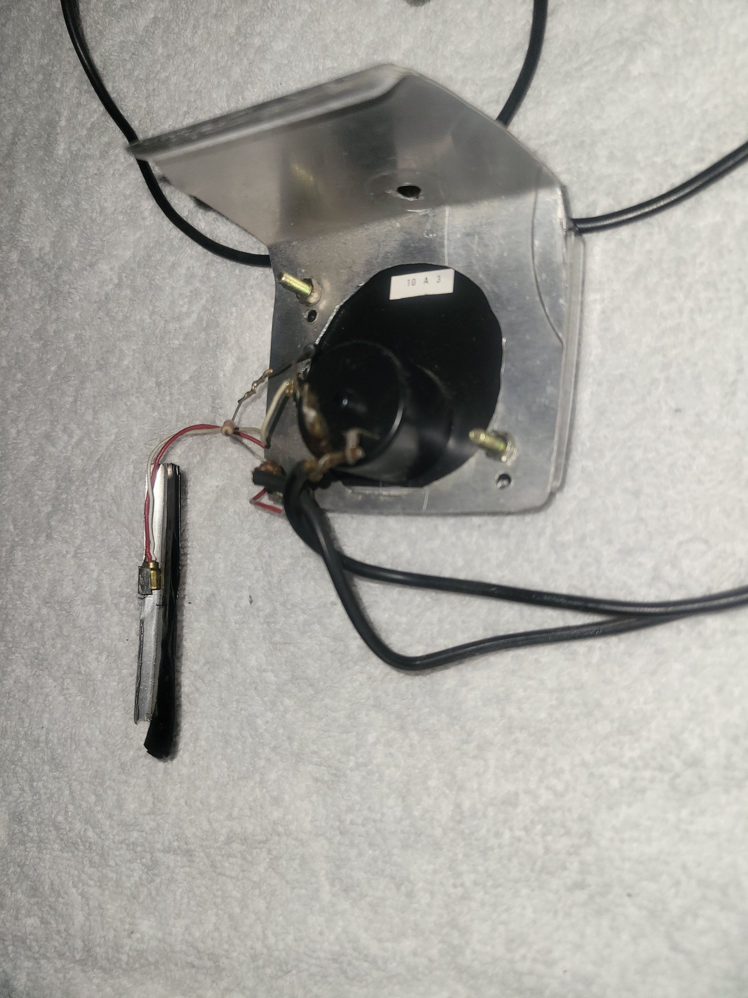

I understand this is not the correct forum for my car, but what I found has nothing to do with any model or year car.
What I did not mention (did not think it had anything to do with the the fuse and wipers.), the engine would not kick down to a normal idle regardless of how warm the engine got or how many times I hit the peddle. I had bout given up and decided to use my new PowerProbe Open/Short finder one more time. The probe led me toward the passenger side of the car around the ashtray. I decided to actually take a good look in that area. I saw a wad of green sticky paper. I ran my hand up in that area and found whatever that was pictured below. I took a video and found it was jacked into the choke heater fuse, and (I guess) grounded to the dash board. I removed the end jacked into the choke heater fuse and started the car. No more fuses blown, car dropped down into a normal idle and purrs like a kitten.
As for as the wipers are concerned I cleaned the connector of green stuff and they work (no washer fluid though). It's my belief someone placed that thing under my dash to cause a number of issues.
For the record, I just purchased the car in mid December off of Ebay
Can someone tell me what this is?

Re: 1986 Caprice Classic Gauges Fuse Keeps Blowing
Originally Posted by suggie
It's my belief someone placed that thing under my dash to cause a number of issues......
No, I do not believe it was a deliberate attempt to sabotage the car, I believe it was a VERY ham fisted attempt to measure the current something was drawing, that something being anybody's guess.
The three facts we know are; It is a meter that measures current, it doesn't belong there, and the car runs a lot better without it.
Beyond that, I'm far too old to waste brain cells trying to figure out what some idiot was attempting with that, and I congratulate you on your successful diagnosis and repair.......

Wow!
I have not come across an Ammeter that appears to be a Pre-1980s Instrument...
Let alone EVER seen one "Jerry-Rigged" into a Vehicle!
I could imagine someone connecting an Ammeter temporarily, for testing purposes...
But NOT actually INSTALL the Instrument into the Vehicle/ Dash-Board!
I have absolutely seen far crazier things done to/ with Vehicles ...but this is a new one for me!
Not to mention that it ONLY reads up to 1mA (0.001 Amps)... 30mA is where the Draw will usually drain down the Battery in a few Days.

This (the pictured device) was installed underneath the dash board (out of site, covert). As stated above I was about to take the car to a mechanic, but searched one more time and happened to find it.
