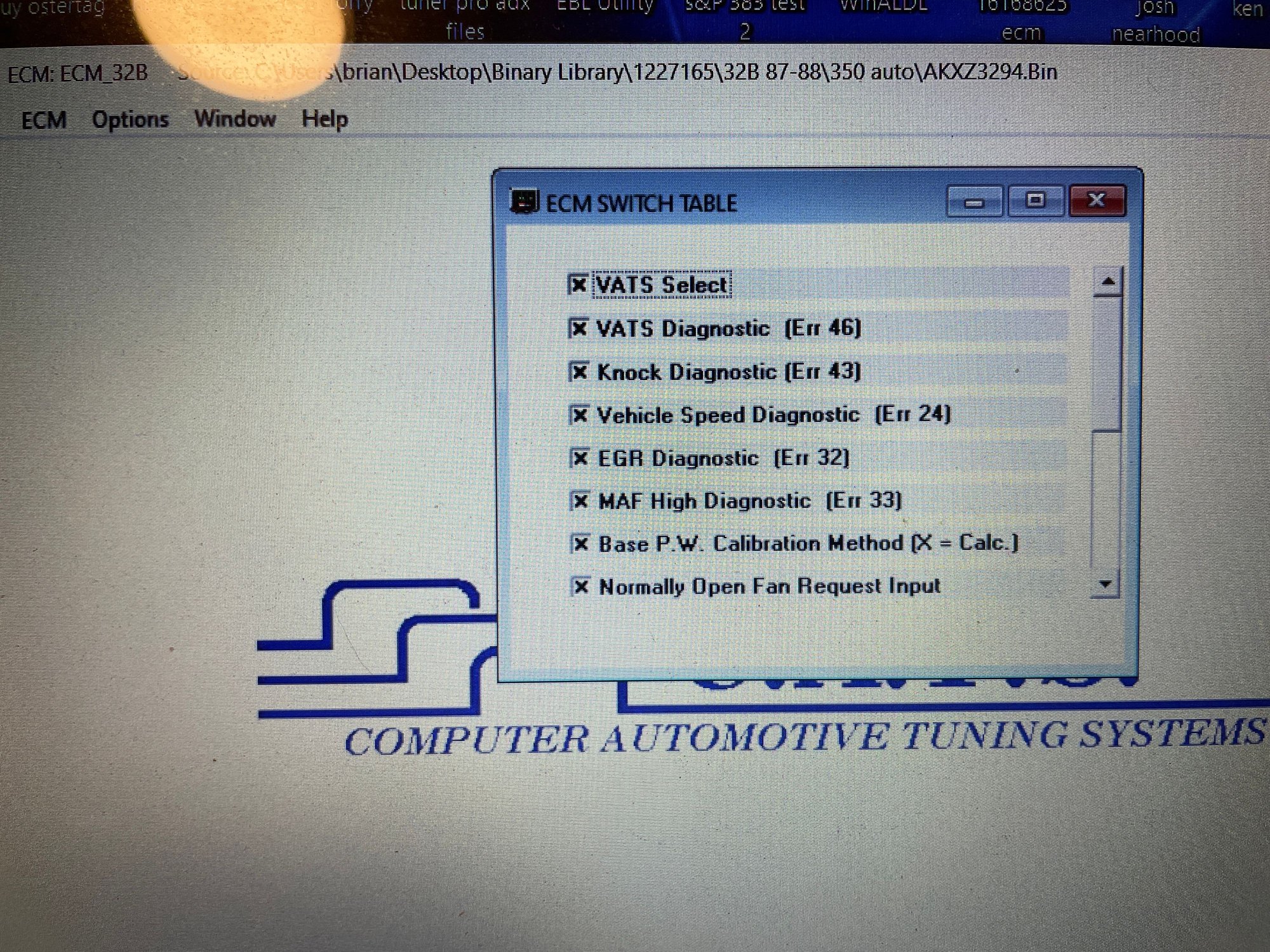

Old Feb 9, 2022 | 06:25 PM
Tuned Performance's Avatar
Community Influencer
iTrader: (94)
Posts: 16,752
Likes: 996
From: Mile High Country !!!
Car: 1967 Camaro, 91 z28
Engine: Lb9
Transmission: M20
Re: ECM no power?
chip code akxz for 88 350tpi automatic.
was released on 05/19/87 and has vats enabled.
if you don’t have a passkey module and resistor probably won’t see a hz signal or 2.5v at ecm for vats.
i was referring to ecm constant power at pin b1 , c16 accessory power at a6.

Old Feb 9, 2022 | 06:42 PM
iTrader: (94)
Posts: 16,752
Likes: 996
Engine: Lb9
Transmission: M20
Re: ECM no power?

You still have a vats issue you need to address
. Your the best one to help fix that. If I get the bypass module referred to above. Do I try each wire until it works? Or only get one shot at it and gotta get another till I get the right one

You can try each wire until it works.

You can tap into ecm
accessory power and ant ground. I think it’s 30hz signal .
if you choose the chip option send me a pm but modulation module works fine .

https://www.thirdgen.org/forums/elec...ts-bypass.html

Tuneperf. Nothing says it plain and simple.. red wire goes to ignition? Ton of wires go up the column.. does this thing tie to the 2 white wire coming out of the column? Like the red to one and the white to the other and black to ground?
red can goto a6 of ecm no it connects to ecm not passkey module. White to b6 of ecm

Black wire to? Body or ECM?

Ecm ground or dash frame. Try grounding blue wire of module and try to start green might be ungrounded.

So I don't fry something, do I cut any of the wires? Or just splice into all of them.? B6 is the one I have mostly in mind

Splice wires b6 can be cut or spliced since passkey module is not operating.

Just a word of thanks to everyone who helped me deal with this challenge. Last week I got the module soldered in. Today I pumped 4 gallons of the seafoam gas mixture out of the tank and added 4 gallons of fresh 4.00 a gallon gas in the tank. 1 shot of starting fluid for fun of it and 2 turn's of the key later we have a running 88 formula with a 5.7 Tpi. I think this project has been in the works for over 7 years. Not ready for the road yet. Figure another month. Needs sub frame connectors and original drive shaft installed. Thanks again
