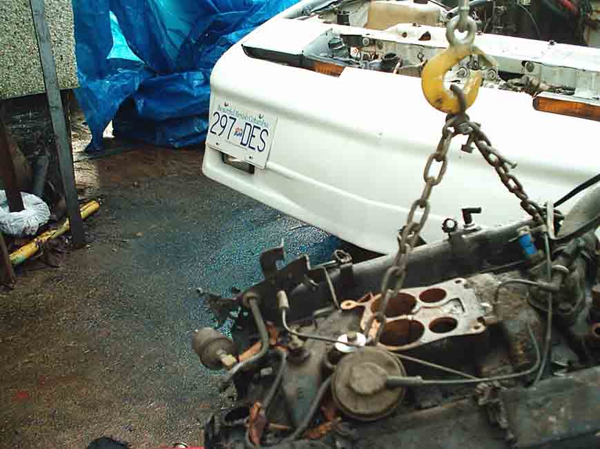

Ya, i just got my engine out yesterday. took it off with the bellhousing attached, just like that.

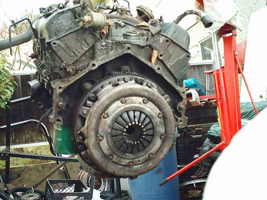

heres another pic

That is a pretty greasy lookin engine you got there. What are you going to do to it? just clean it up or add some performance stuff to it.
Can i use one of the bolts that holds the waterpump on to lift the engine out. I mean to hook the chain to it?

Im not doing anything with that engine. my brothers gonna use the heads.
Im putting in a newer slightly less bagged engine. I painted it chevy orange! and im replacing the clutch disk...
