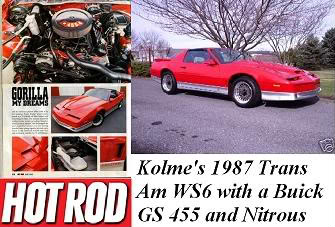

I cant find the hot rod magazine issue but heres a great link for you
http://www.bangshift.com/forum/index...e;topic=8793.0
http://media.photobucket.com/image/t...ransAm-455.jpg
Old Mar 23, 2010 | 09:41 AM
KrisW's Avatar
iTrader: (6)
Joined: Sep 2004
Posts: 2,777
From: Casselberry, FLA
Car: 88 V6 'bird/89TBI bird/85 T/A
Engine: 2.8/TBI/TPI
Transmission: V8 T-5/700R4 x2
Axle/Gears: 3.42 open/2.73 open/ 3.27 9 bolt
Re: Anyone else using Olds 455 in 3rd gens????
That's a Buick 455.
I like them better, but its not an Olds. It is however, an 11 second car that is mild on the street.
Very nice combo...
