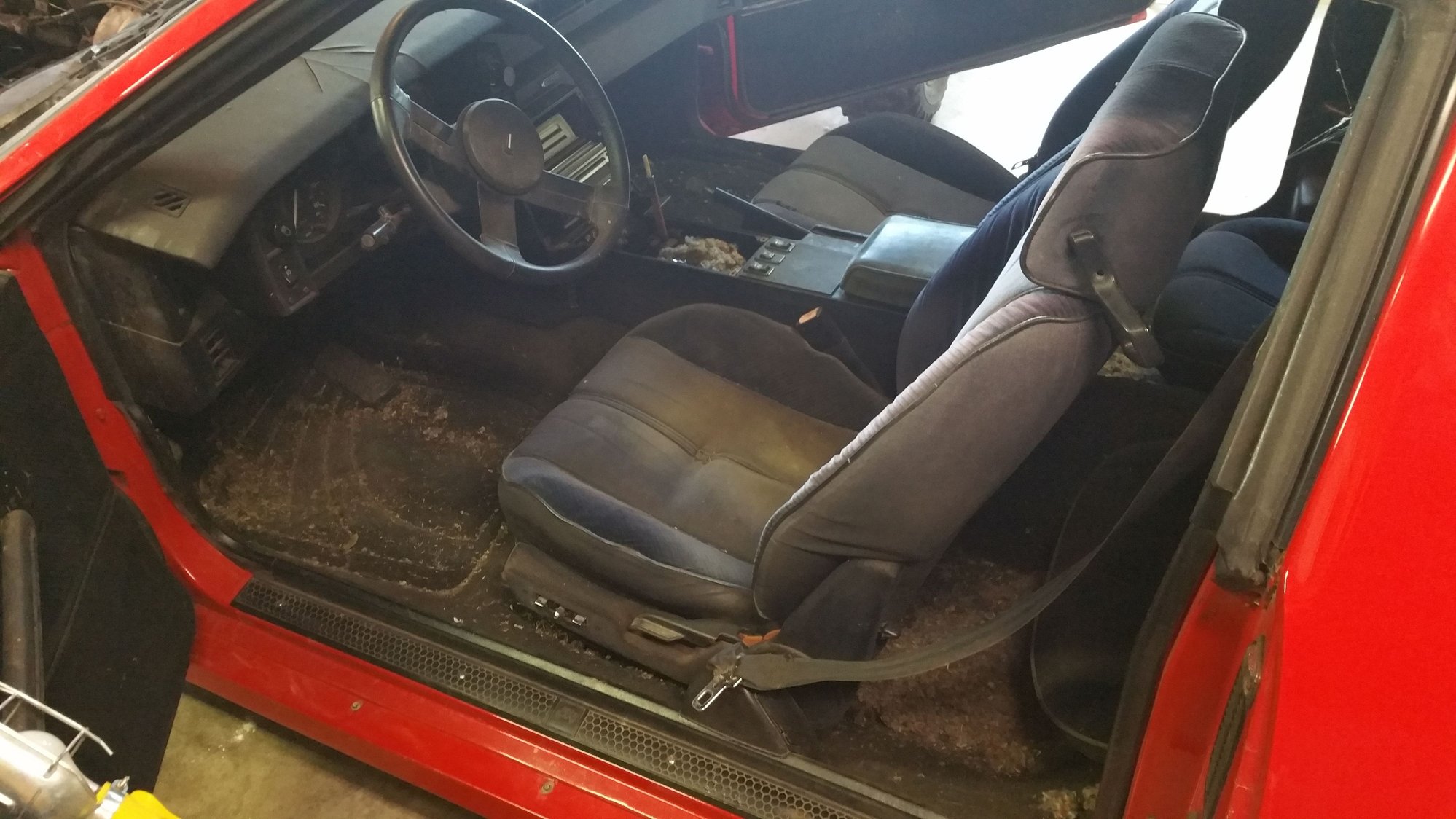

Ok, going to try this out with the pictures to document our swap. Its the 305 to 383 swap we decided to to put our ROC through. Before we could get there, there was quite a few things we went through to get to that point. From the beginning, I bought this camaro from a guy that was selling it on Ebay up in Michigan. He actually contacted us after a sell fell through with the winner because we had showed prior interest in it. It was nothing special, just an 86 305 TPI. What I liked is that it was all still pretty much original. A little rough, paint wasn't great and had an aftermarket steering wheel, tires, exhaust, and some stickers-no big deal compared to what was out there at the time. This was my 4th third gen, having a 92 RS brand new, traded for an 89 iroc 5.7, crashed that and got an 87 firebird with a v6. That was all gone in the 90's. I wanted to get my son who was about to be born a 3rd gen to hand down to him 1 day, and I knew that the time was right to get one while they were still cheap and plentiful. My check for this one actually cashed on the day he was born! This was back in 2005. I stored and drove this car around for the next couple years, grabbing parts for it here and there. About 4 years ago, this car was leaking oil so bad all over the exhaust that I just parked it in his grandfather's pole barn. During that time I decided to go ahead with getting an engine for it. I just wanted to get a 350 to put in it, something very simple, the typical 305-350 swap with out having to do to much since I have never worked much on cars. As my son and I got more and more into this, it progressed to the sickness/addiction that it has become.We are now putting in an ATK 383 with a Holley Stealth Ram that we ended up buying straight from Holley after they used it on a SEMA car. When the car was sitting it of course got invaded. Not just by mice, but a ground hog burrowed a hole up to the underside of the engine and made a home there, raccoons climbed and scat on it, and of course the mice ate wires, seats, insulation-you name it. Needless to say it was devastating but we did have plans on redoing alot on it anyway. Fast forward to about just over a year ago, we pulled it out with a come along and trailered it to our garage.We washed off a couple years of barn abuse. We had to tear out the whole interior and air it out. Then we started on the wiring. Lots of fixing as you will see in the pictures. Almost the whole interior wiring, from front dash to the auto trunk pull down (and rebuilt that too). Cleaned everything a couple of times, fixed a small bubble on the floor and then installed hush mats through out. Put in new carpet, reupholstered the seats, new correct steering wheel, seat belts (nos), carpet on the plastic panels, and even a new console, lid, and shifter and ebrake. Swapped the 86 shifter for a later one, and new headliner. I bought a original dash that was perfect, but it cracked within a couple of months. I replaced that with a brand new repo. You cant even tell. We have fixed collapsed lines on the brakes, new calipers, put on new wheels and tires, and a new muffler. We then have been working on the last couple of weeks on getting this motor pulled. We will totally clean up the engine bay and get everything looking good before putting this engine in during this winter. I also purchased some new pins/bushings/hinge kit for the doors. The drivers door is starting to hang up from sagging. I also will be putting in a new heater core that I have sitting here in a box while everything is out also. We are thinking of spring having this new motor in, and then of course the fun begins of trying to get this thing tuned, This is the only part I really worry about. I have all the stuff from Moates, but without any skill in that dept. I doubt that will go anywhere.
NIIICCEE, I mean miiiccee...
Mice drug insulation everywhere!
That and how we will get this thing to a shop where we can get the headers done and the new walboro pump put in. 2 things I can't accomplish in my garage. Oh well, enough with the background, enjoy some pics!

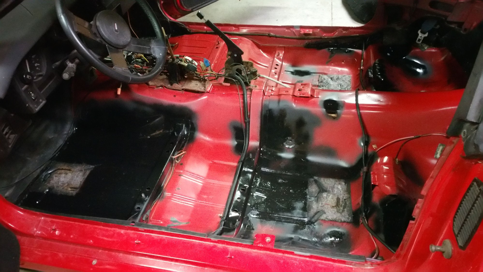

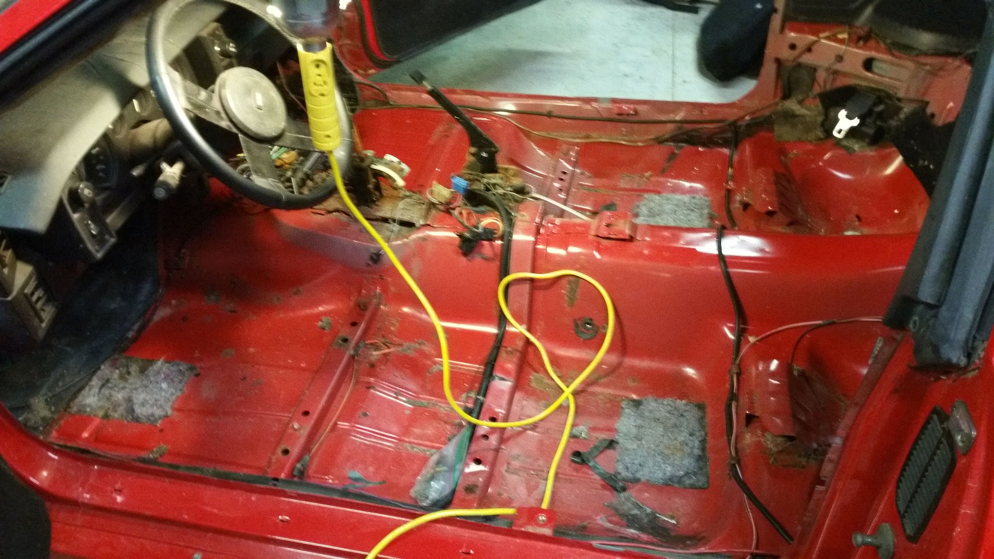

This is after getting all that stinkin mouse i
Floors actually look awsome-guess that nasty under coating really works.
fixed what little rust there was and sealed it.
starting with the hush mat
nfestment out and starting the interior work.

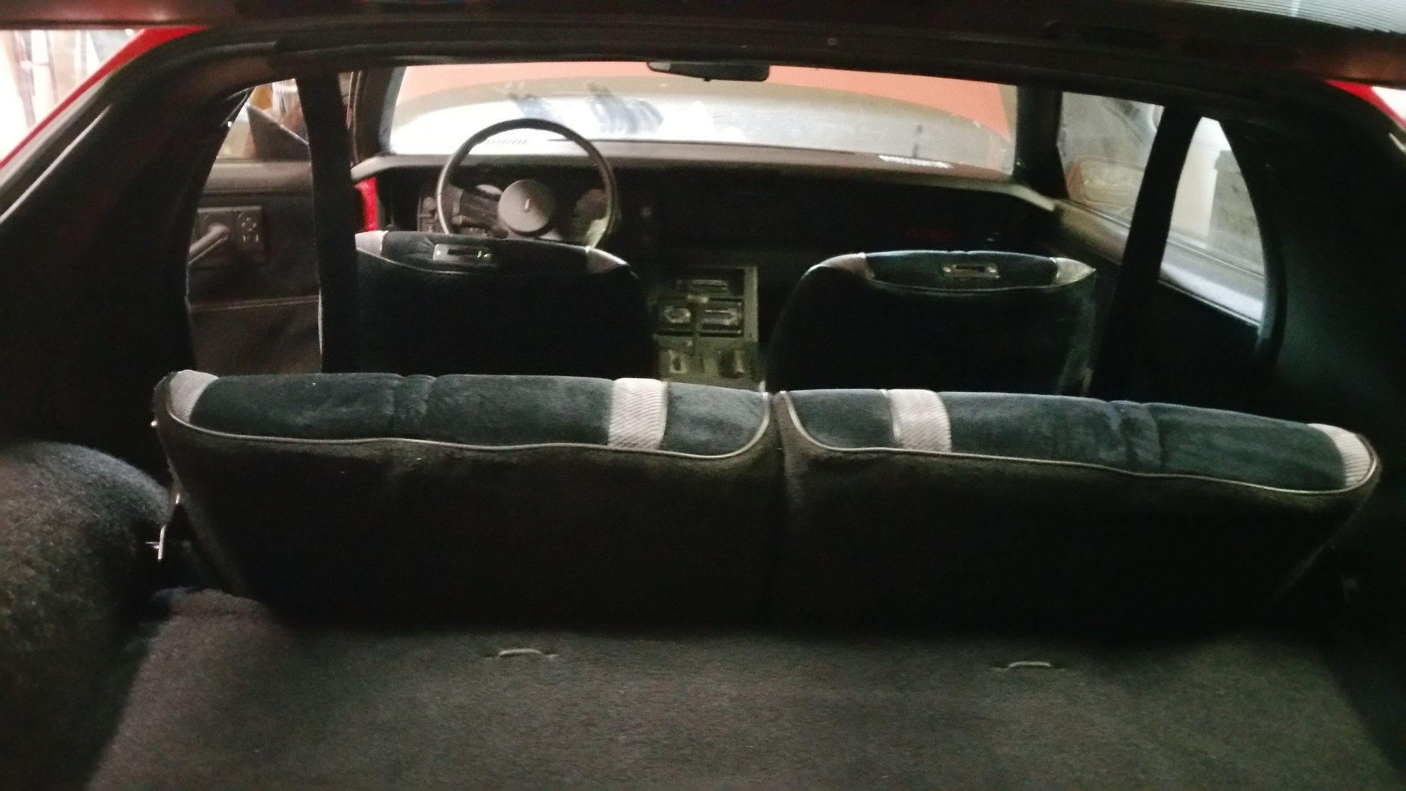

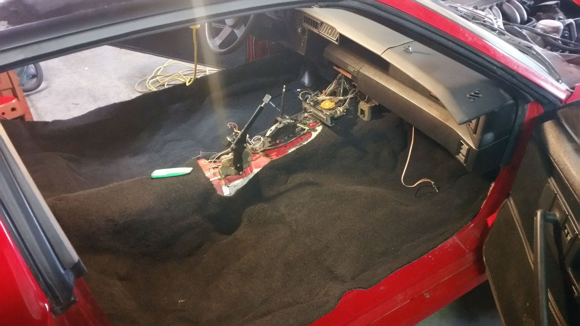

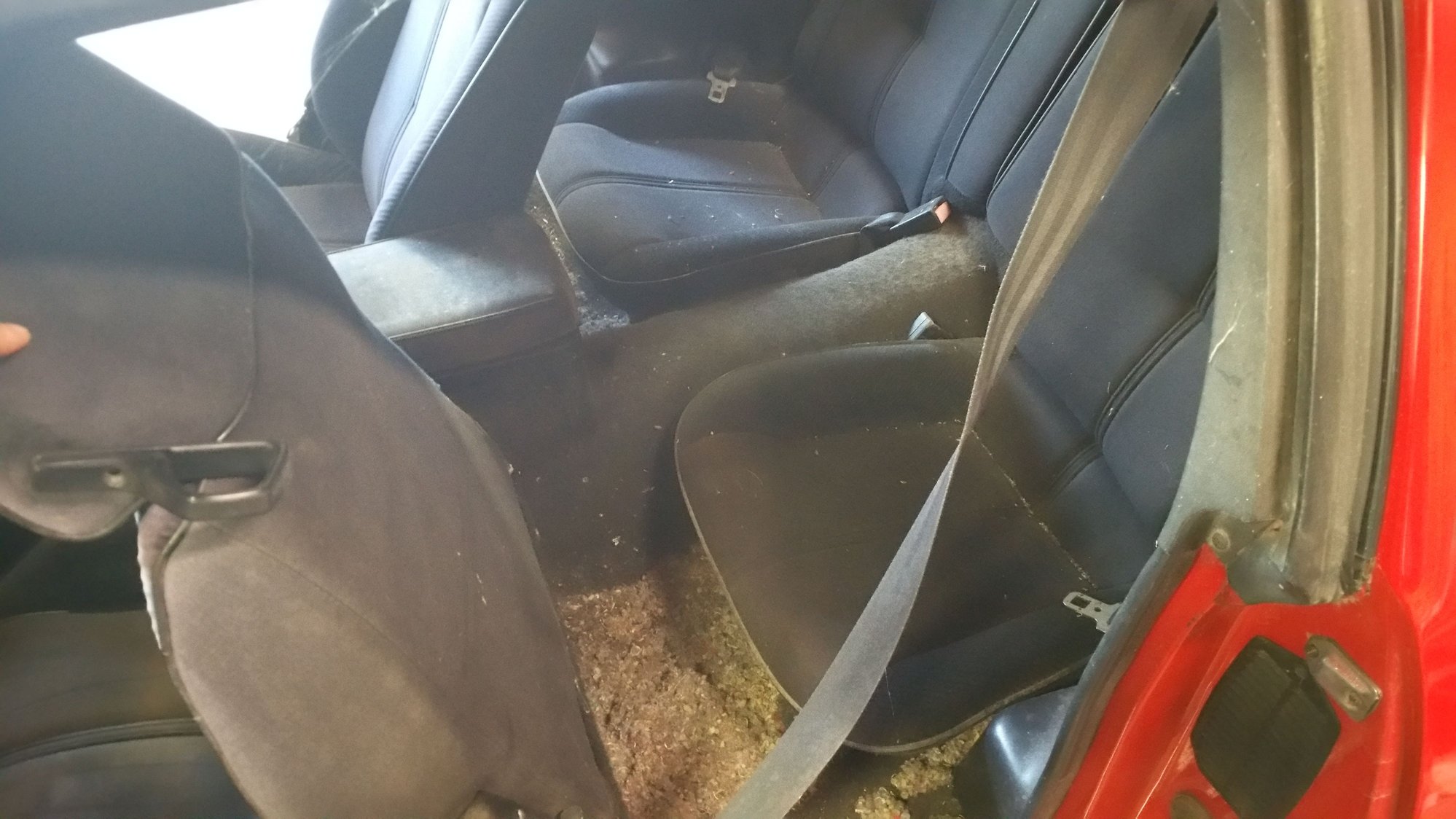

Finally getting some interior back in.

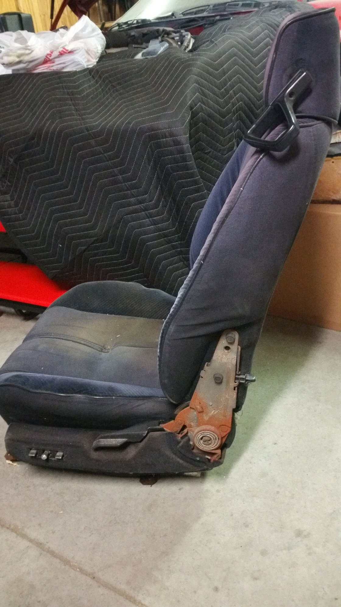

reupholstering the seats
before
not working and rusty
new interior back in, derusted and repainted and everything working

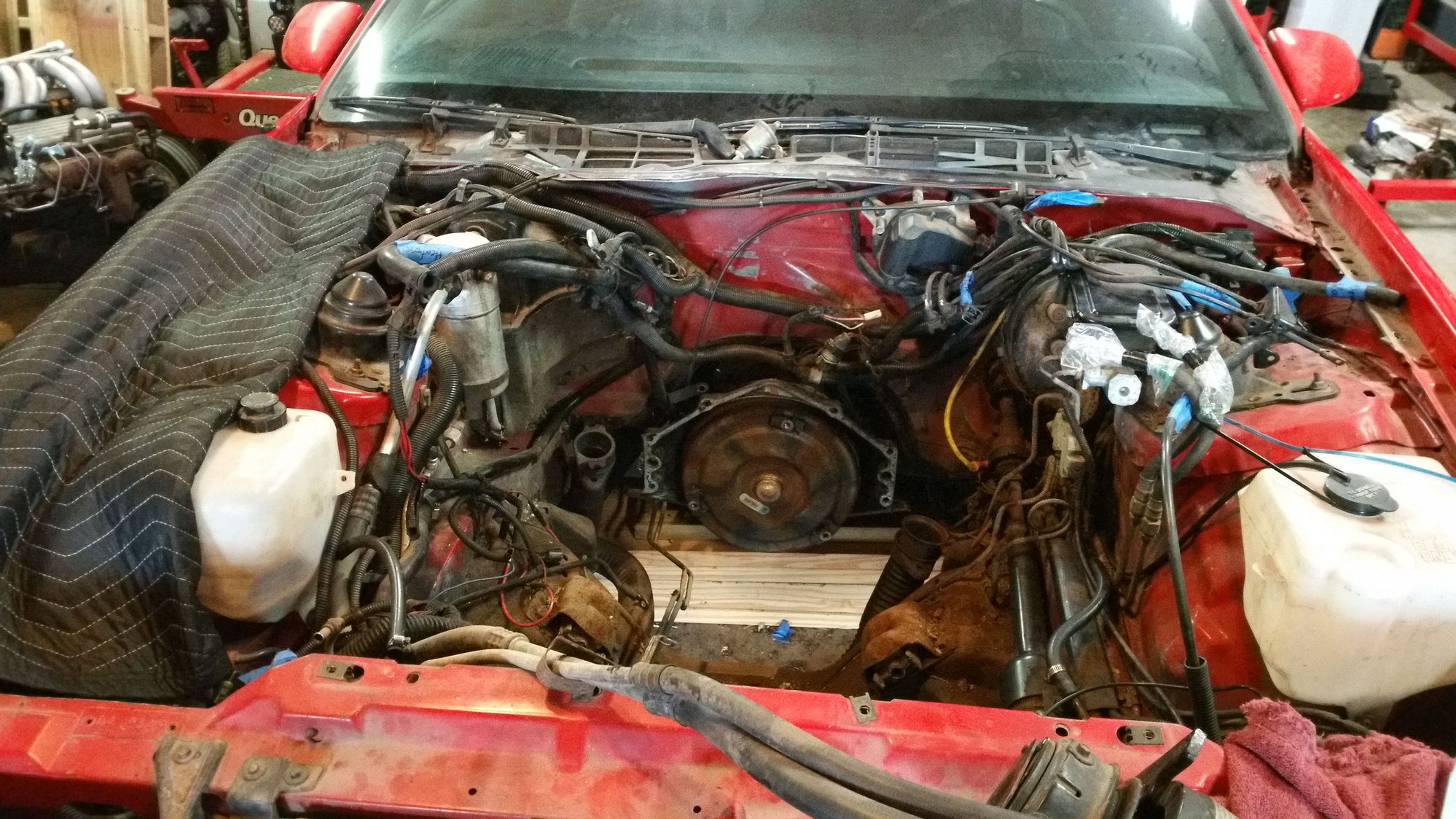

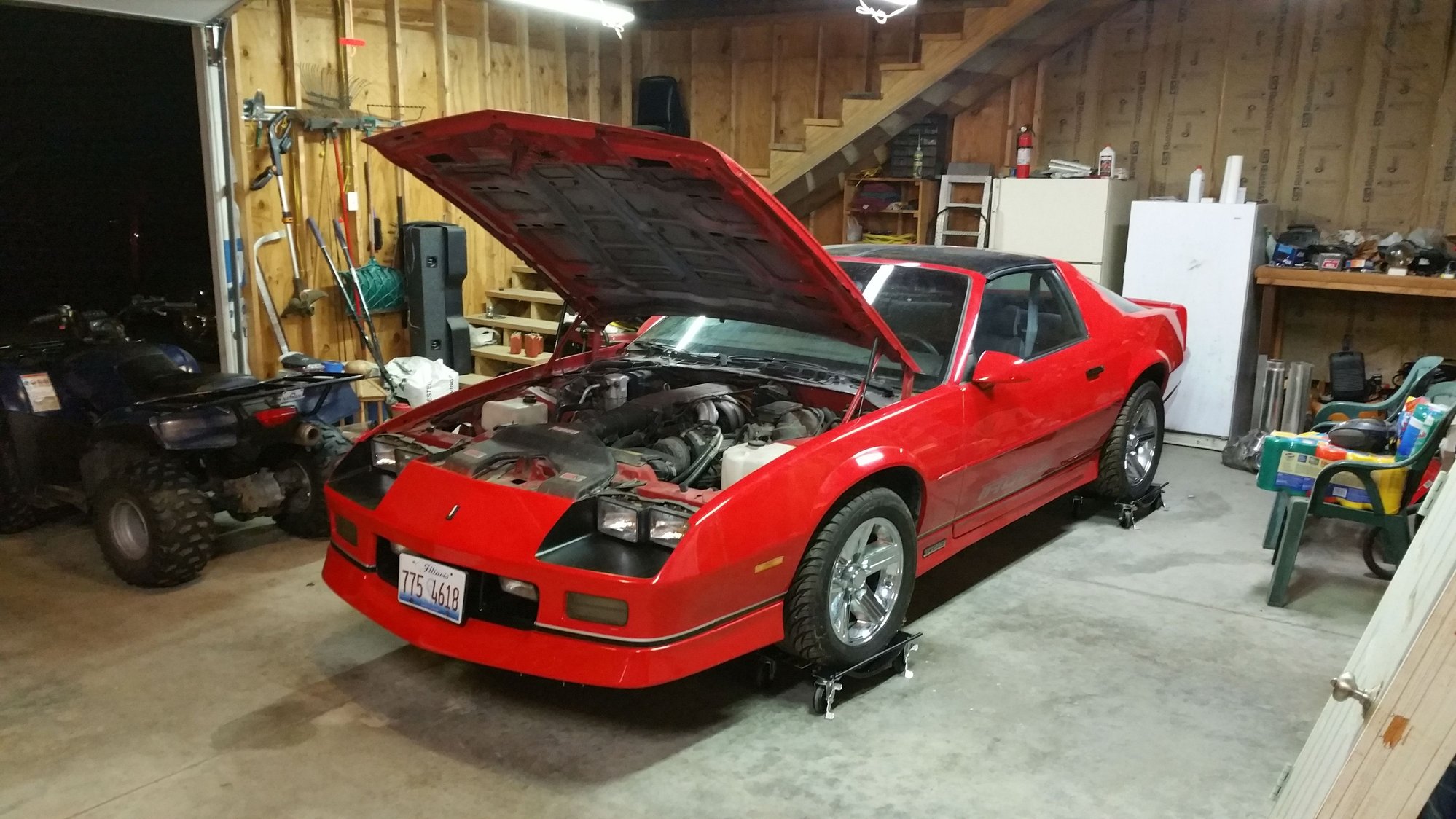

The car as it is now, getting ready ready for the new implant!
getting ready for the pull!!
And it's out!!
