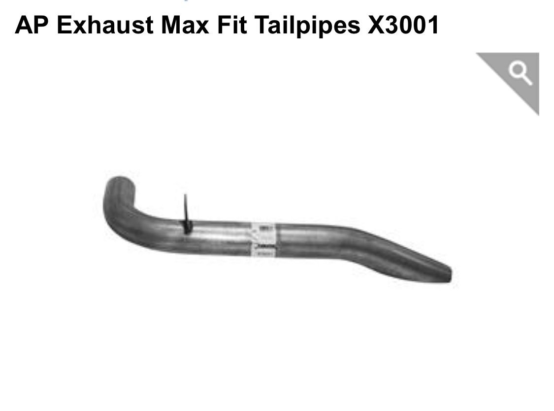

These Tailpipes look pretty stock.. I was looking at swapping out my straight pipes with these..
https://www.summitracing.com/parts/a...iABEgKLIPD_BwE
https://www.summitracing.com/parts/aph-x3001/?rrec=true

These are the closest thing to factory tail pipes.
[img]https://www.thirdgen.org/forums/atta...ps6csuwzjg.jpg
http://www.ebay.com/itm/301873320480...%3AMEBIDX%3AIT
http://www.ebay.com/itm/231846324013...%3AMEBIDX%3AIT
Well I guess the eBay links expired. They are made by Xcelerator and ordered from Carid https://www.carid.com

I think those are the same that I posted.. direct fit to the Xcelerator muffler..

Yup, those are them. If someone could combine those tail pipes with one of the OEM GM mufflers from my first link, it would take a sharp eye to tell it wasn't factory.

Thanks for all the advice. I went with a Walker 18375 SoundFX which is advertised as a drop in replacement and being the OEM sound (perforated inner tube muffler). For the tailpipes I went with the AP. Those bevel cuts are OEM.

Depends on the tail pipes. Those AP exhaust tail pipes are close to 82-89-ish pipes. 91-92 pipes actually turn down.
The closer exhaust was what was left of the stock trash on my 86 TA. The further is the Walker Dynomax 2.75 intermediate pipe (46669?) with the stock muffler and tips from my 91 Formula. FWIW the muffler and pipes on my Formula now are from a 93-97 Formula or Trans Am, it's the same exact muffler but with slightly longer pipes and the Quad chrome or stainless tips. To be honest, the tucked turn downs on later thirdgens just give up a little too much pizzazz.

This Is My Factory Muffler,The AP Tailpipes Are The Best Factory Match.
