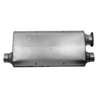

A single 3" exhaust system with mandrel bends flows enough to support about 325HP without losing any power. The straight through mufflers like the Welded Ultra Flo and the MagnaFlow flow enough to easily support 325HP. I've never seen an 80-series flowed, but a 3-inch, 2-chambered 40-series only flows enough to support about 185HP before robbing power. The 40 series will flow more than the 80-series. As you can see in the picture below, the "exit area" and dual exit pipes takes up over a third of the 80-series muffler volume - so the actual muffler size is something like 6-wide x 10-long x 5-deep. So it’ll start robbing power on an engine making less than 180HP. It’s a terrible performance muffler - your engine deserves better and will thank you.

Ordered the Magnaflow 12267. Seems like it will do the trick. That Flowmaster sounds great at idle and light to light but completely intolerable at cruise. Deafening actually. Was toying with the idea of an Aerochamber as well but that Magnaflow, based on the sound clips, seems to have it in all the right spots. @BadSS that FLowmaster chamber looks like a recipe for very turbulent air, especially the turn to the outlets. Spend all that time and money on the front end streamlining the incoming air only to bung it up on the exit side makes no sense to me.
