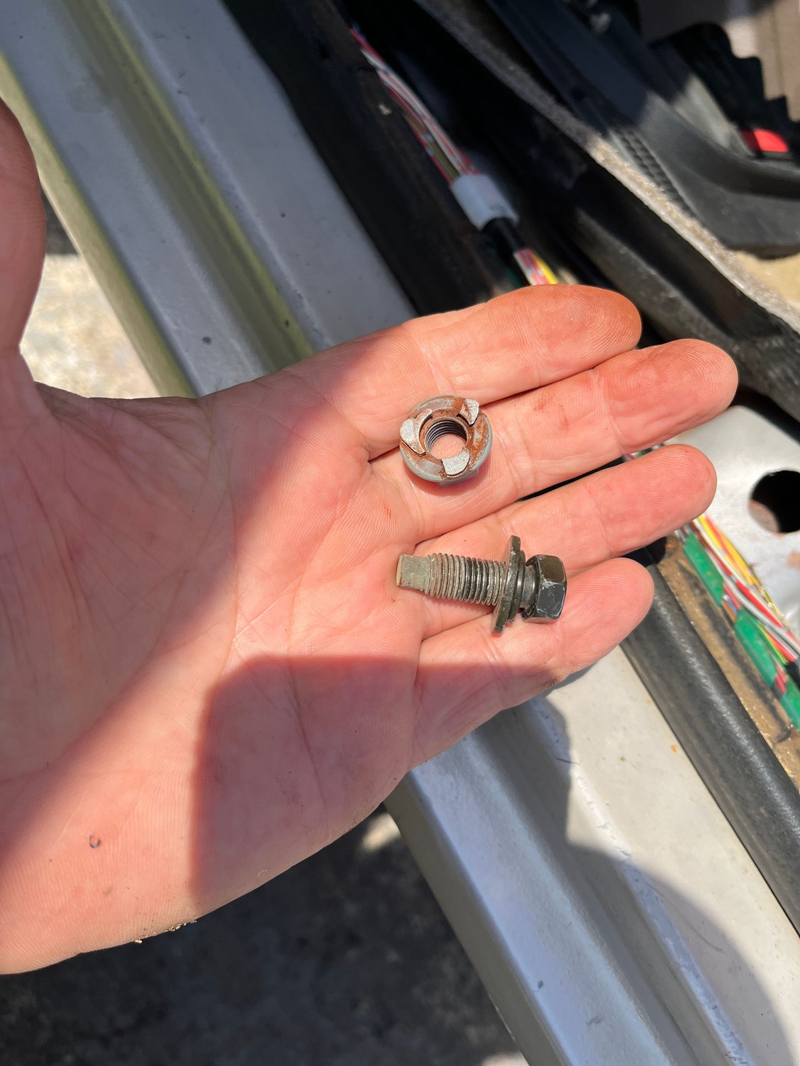

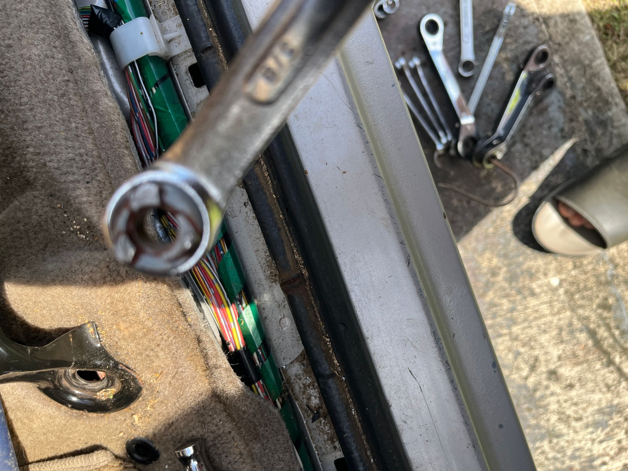

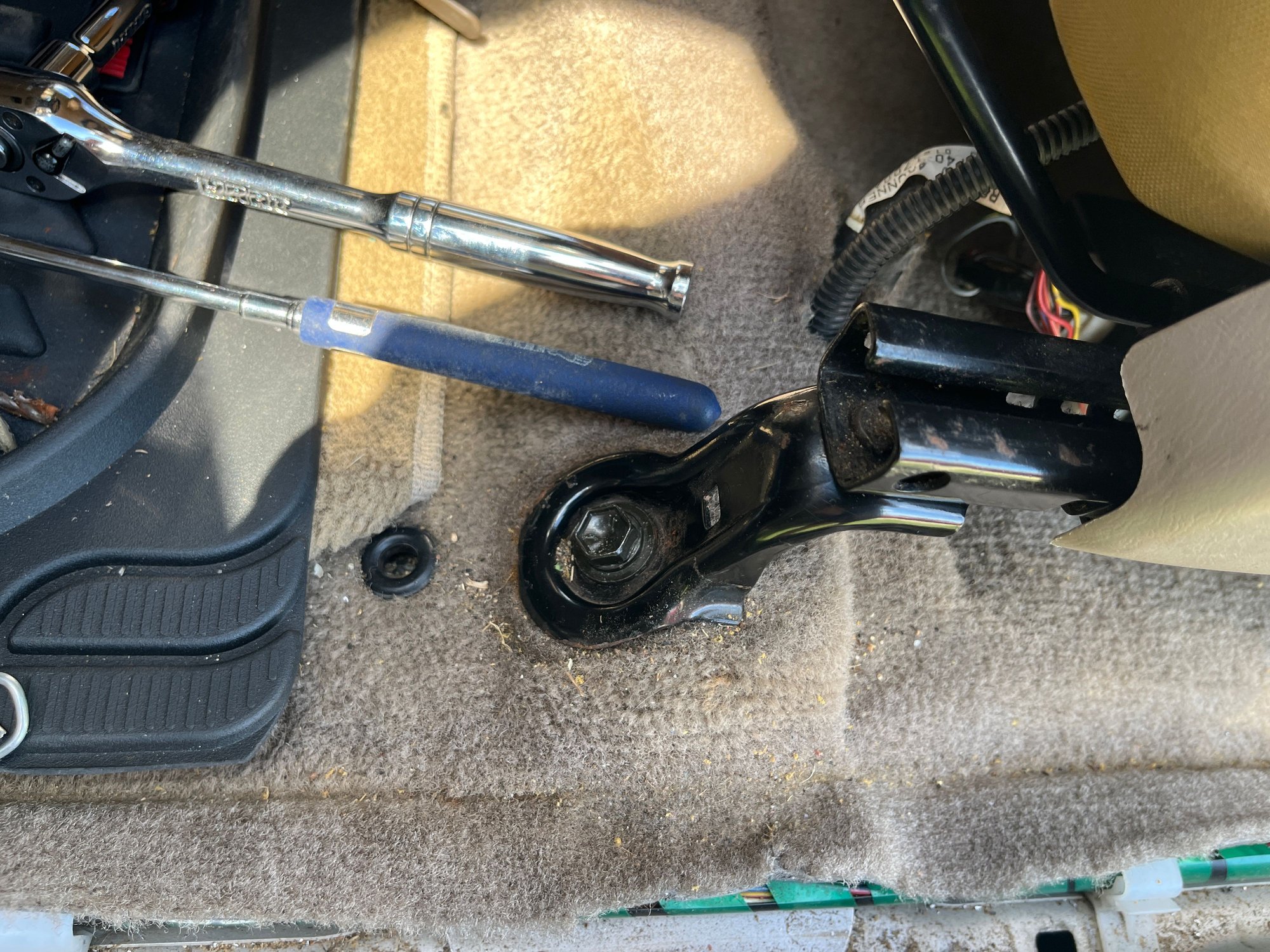

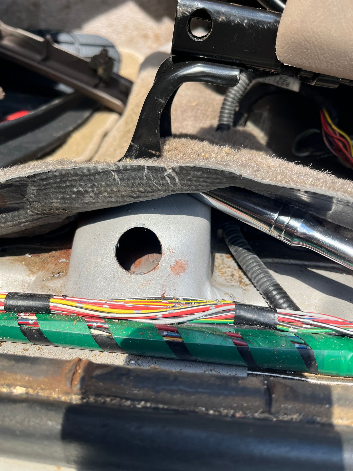

Get a Step Drill Bitt and drill hole large enough to retrieve nut with a magnet, get correct socket wrench and use tape to avoid nut from dropping off wrench, insert nut and wrench into hole and present it to the bolt, tighten bolt from the top, use a metal washer with the nut if nut hole is too big, took me 20 minutes
