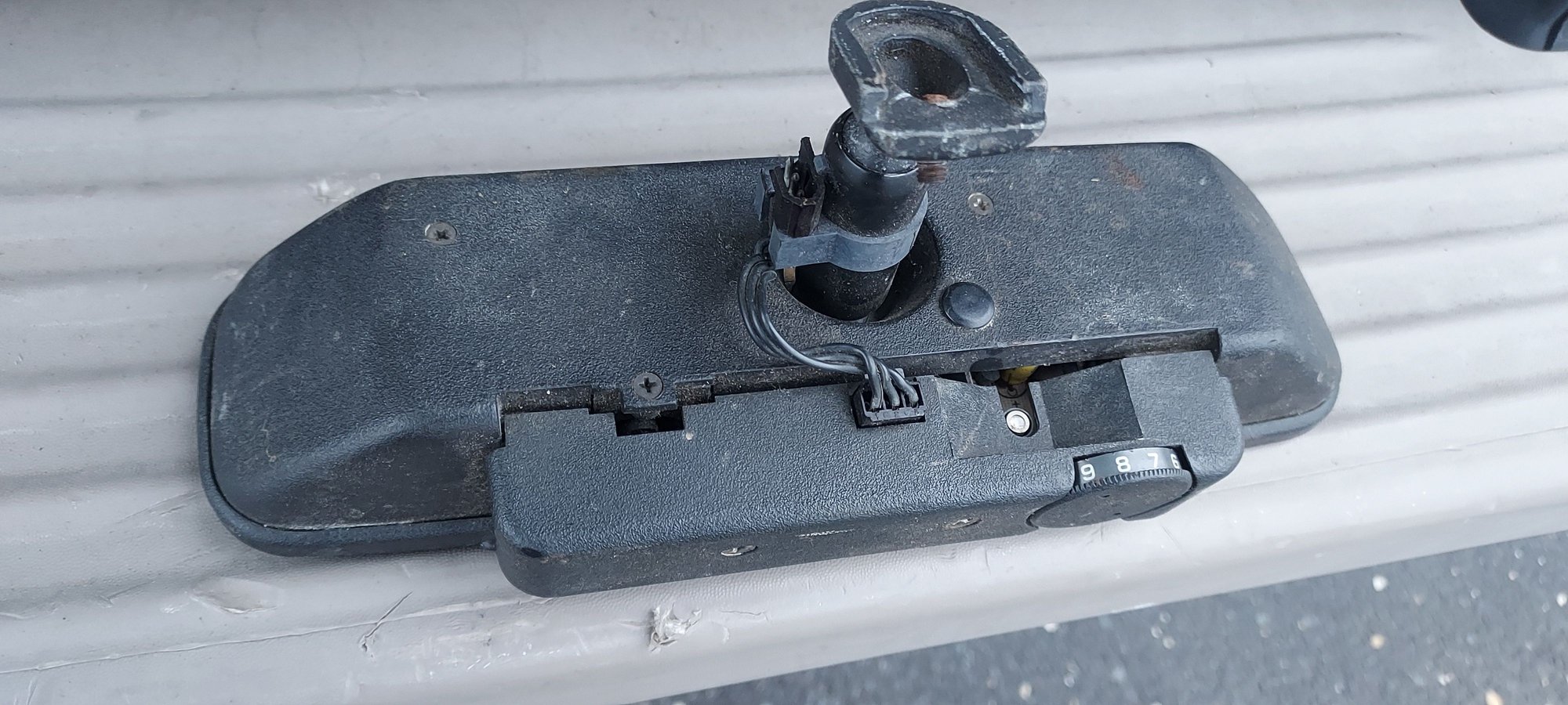

Old Apr 6, 2022 | 07:46 PM
Ponch85rs's Avatar
Joined: Oct 2004
Posts: 17
From: Norwalk, CT
Car: 1987 Chevrolet Camaro Sport Coupe
Axle/Gears: 3:42
Re: power rear view mirror with sensor??
I think this is what they are talking about. I have one.
