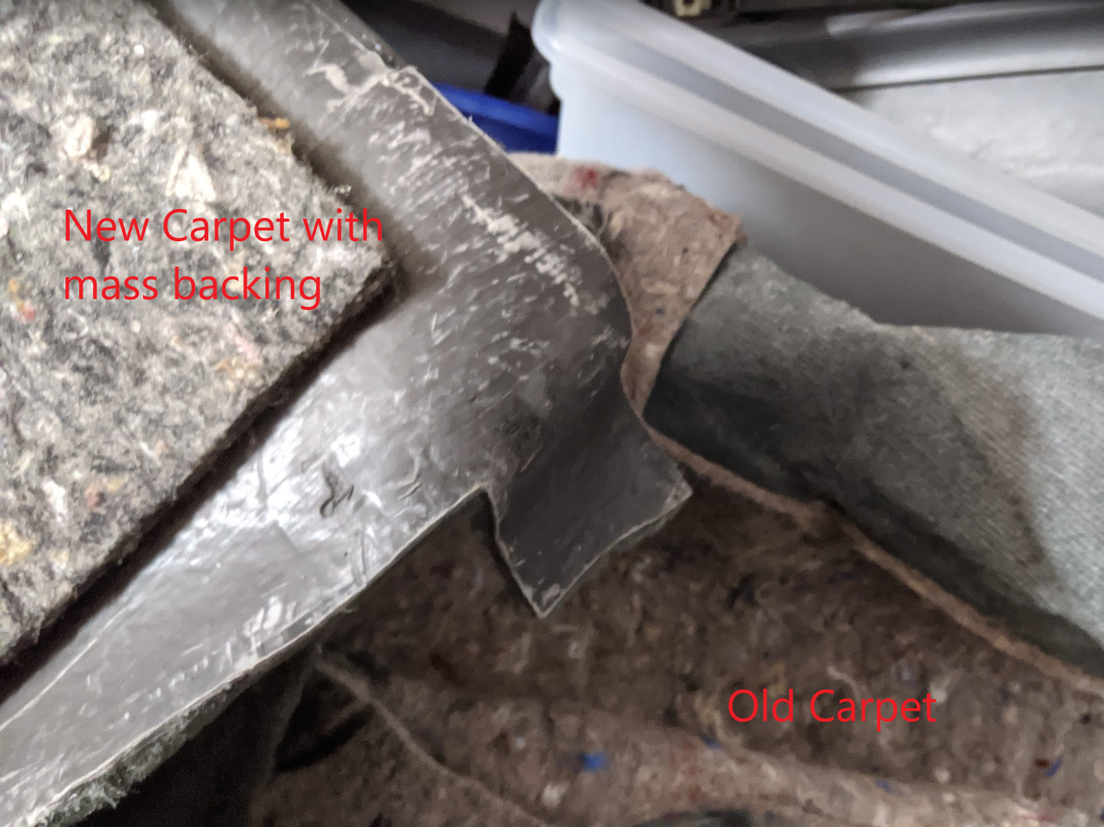

I've pulled all my carpet out to replace it, and I had to drive it to the shop to get the A/C fixed again. No A/C, no carpet, 90+ outside. The car turns into an oven.
I went with the ACC deluxe carpet with Mass Backing. I've already applied lots of kilmat and fatmat the car, just need to trim down the carpet and install it now. I'm also putting foam on the inside of all the trim before installing to reduce rattles

Re: Queston about carpet and sound proof/heat
Originally Posted by theraymondguy
What difference have you noticed? I’m looking at the acc carpet from RockAuto.
The carpet isn't in yet. But if you compare the old versus the new, you can see the difference.
