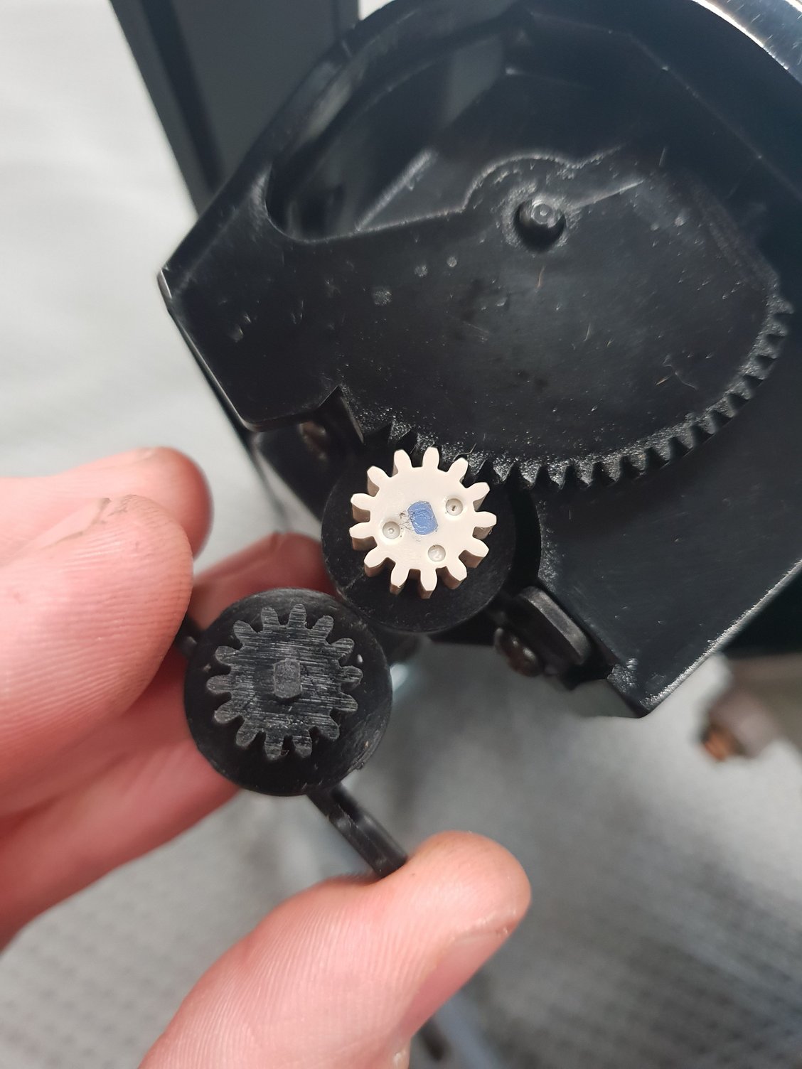

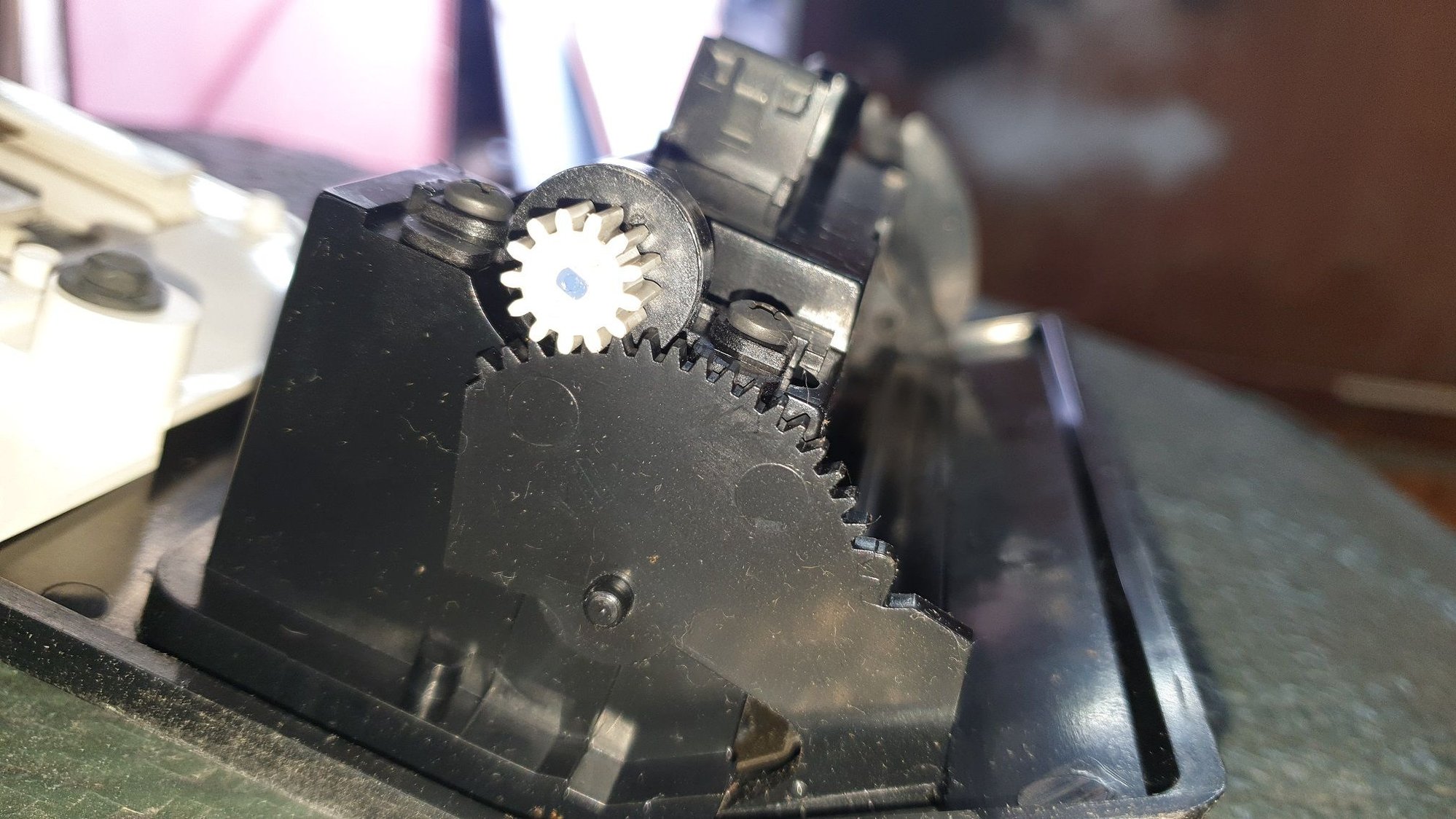

There's a little gear drive that opens the lid smoothly.

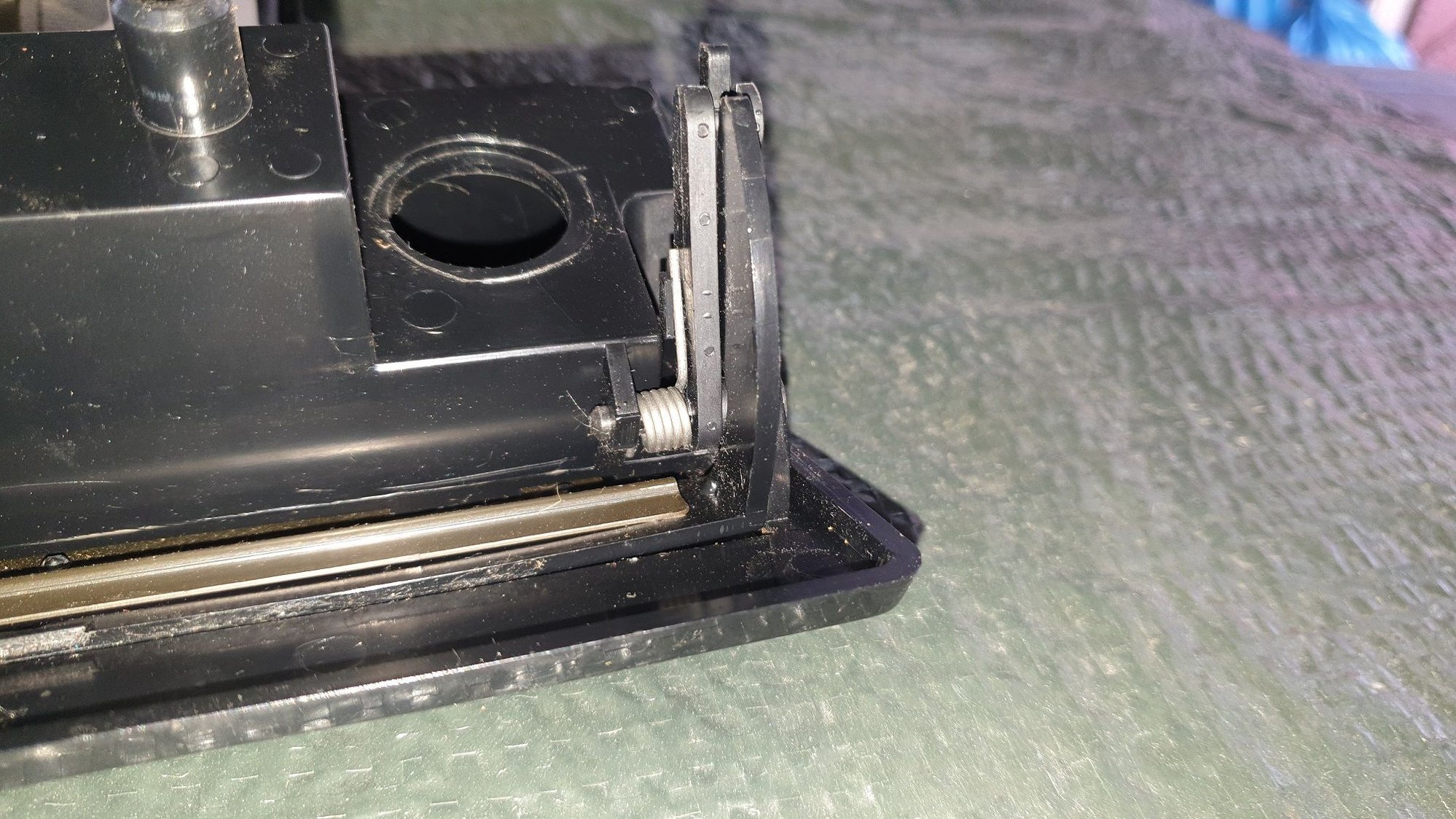

Do you have a picture of the other side that shows the spring location?

Re: 1992 AshTray Pop-Up No longer working
Not on my phone but I can take one tomorrow, I have four shift plates on the shelf.
Originally Posted by brightonrock
Thanks.
Crap, I forgot it yesterday, will do in two hours!
