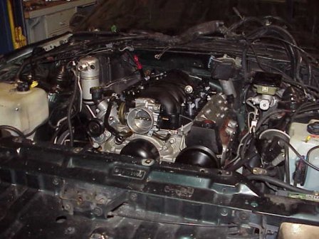

Q: Can you still have A/C with an LS1?
A:
Yes, there are a few options.
1) I feel this is the easiest and lest time consuming option. You can buy the conversion brackets from the parts dealers listed at the bottom of this post. This will allow you mount your stock AC compressor to the LS1 pulley setup.
2) If you want to use the stock LS1 A/C compressor you need to cut away at the engine cross member and notch it as shown here Click here.
You will also need to you will have to fabricate your own AC Lines. Anyone know what type of pipe or hose you would use for this?
The corvette accessories may resolve this problem. As seen in the pictures in the post below you can see that the A/C compressor is in a higher location on the corvette accessories. It may work but I can’t say for sure since I have no way of knowing if it will work.

A/C related (talked about in 1’st post):
ALL PIC’s BELOW taken from http://www.hotrodlane.cc/
Pictures Attached below
98-2002 LS1 F-Body (Camaro / Firebird) accessories setup (right)
Camaro balancer is 3/4” longer than the corvette.
97+ LS1 Y-body corvette accessories setup (left)
As you can see from the raised position of the A/C compressor on the corvette accessories it may be possible that this would eliminate the need to notch the frame cross member to use a LS1 A/C compressor.
Last updated: 9/22/2004

Here is my third attempt at posting a picture
Old Mar 15, 2003 | 05:33 AM
galletti's Avatar
Joined: Nov 2002
Posts: 316
From: Miami, FL
Car: 1988 IROC Convertible
Spring rates
The picture worked. Maybe you answered this before but from what I see you have a ton of room on the passenger side. This you have clearance problems with the coil packs like the Speartech people did?

Thanks for the help. Funny you mention speartech. Thats where the car is right now.
Although there is a fair amount of room, the coil packs only need an extra 1/4 or so to clear the a/c ficture. Rather than cutting ahd hacking the relocation bracked from the truck engine is a better solution.
Some of the 4th gen guys are relocatong their coil packs near the firewall by using some kit. I do not know what the advantage is, but this could be another option for 3rd gen LS1 swappers.
