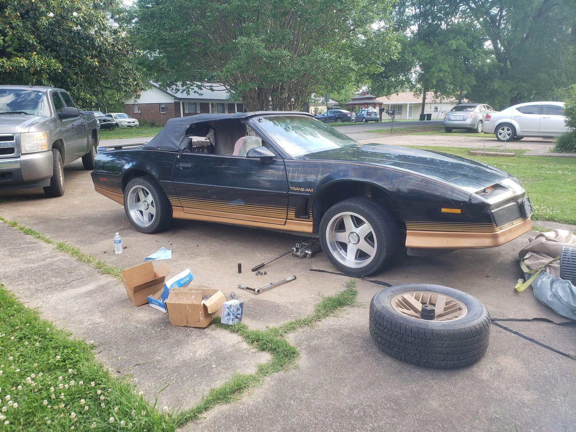

So I am picking up a 2000 SS donor car on Saturday.
I plan to use as much of the donor as possible.
Gas tank, fuel lines, radiator, engine, trans and driveshaft.
questions:
I am thinking I should just notch my k-member or buy an aftermarket k-member?
If i do a k-member, i will need one with spring perches and ls mounts. Which one currently has the best fit and finish, as most of the treads are older.
I plan to keep air conditioning. What compressor should I buy? is the sanden compressor smaller than the regular ls compressor?
Thanks,
Chris
