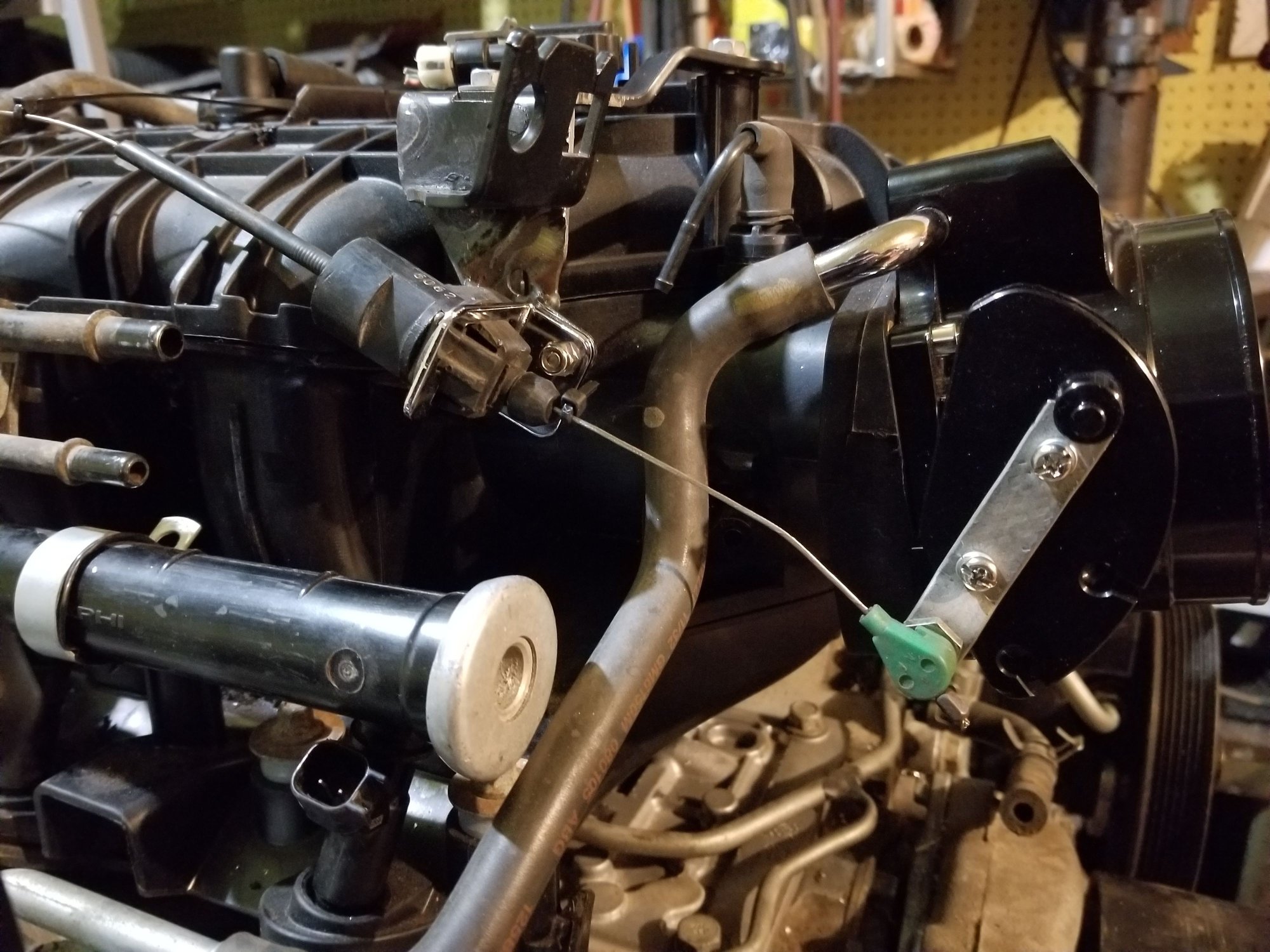

-just ordered the speed engineering headers so that can be crossed off my list. they had good reviews everywhere and a few dyno tests i found put them as slightly better all over than the big $$$ stuff that they were likely copied from. should sound nice with my X pipe and Flowmaster 40 series mufflers. my neighbors will love me.
-my 92mm cable driven throttle body and cable bracket showed up today, just need to fab up the tv cable stuff, which won't be too hard.
-leaning really hard towards the Holley Terminator X 550-905 controller with maybe the fuel pressure sensor and the flexfuel sensor added on so i can play with E85.
-will start ordering the internal engine stuff as soon as it gets a bit more consistently warm out in the garage and things don't flash rust within hours of being taken out of the package. that way i can slam it into the car as soon as i get it together.
i'm starting to feel a bit giddy, since i haven't done this much cool go fast car stuff since i built my Nova over 20 years ago.

worked out the tv cable setup for the 700r4, starting with a throttle cable bracket that i bought and welding a tv cable mount to it, which i located using a mockup cable i had laying around that is hooked to an arm i made and mounted to the throttle lever.. the measurements and angle were based off looking at the TPI throttle body on the L98 that's in the car. cable travel is almost identical to the stock setup in the car, so i can cross that off my to-do list. just need to clean up some welds and shoot some black paint on the bracket.
why doesn't someone sell this premade for the TBSS intake?

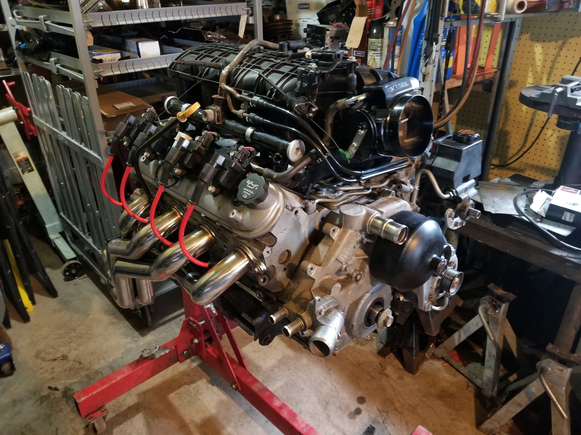

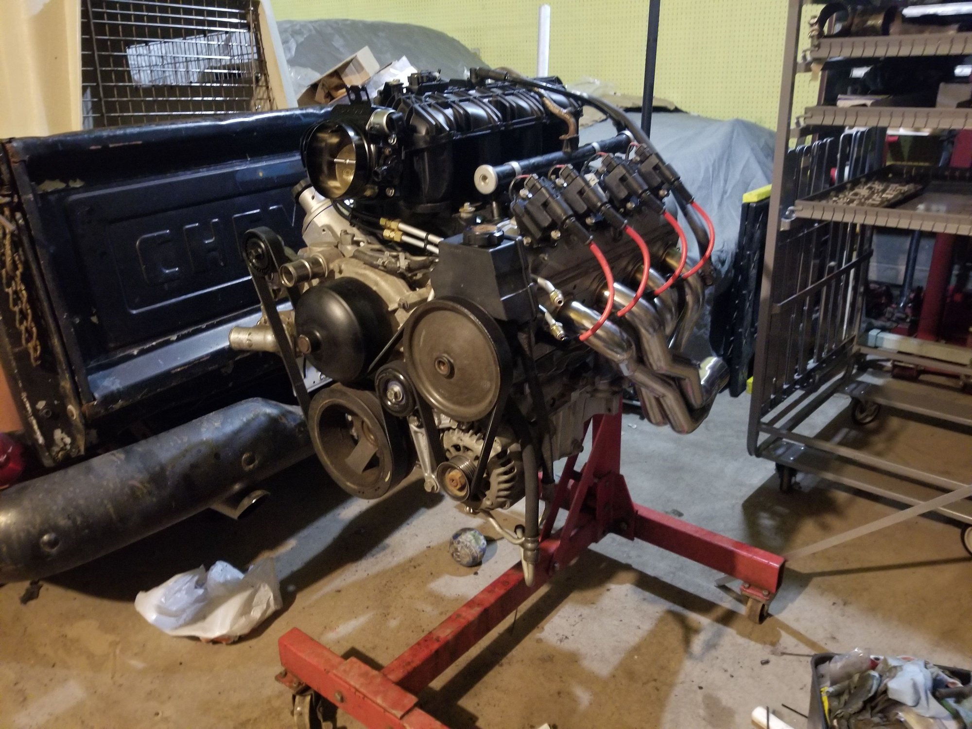

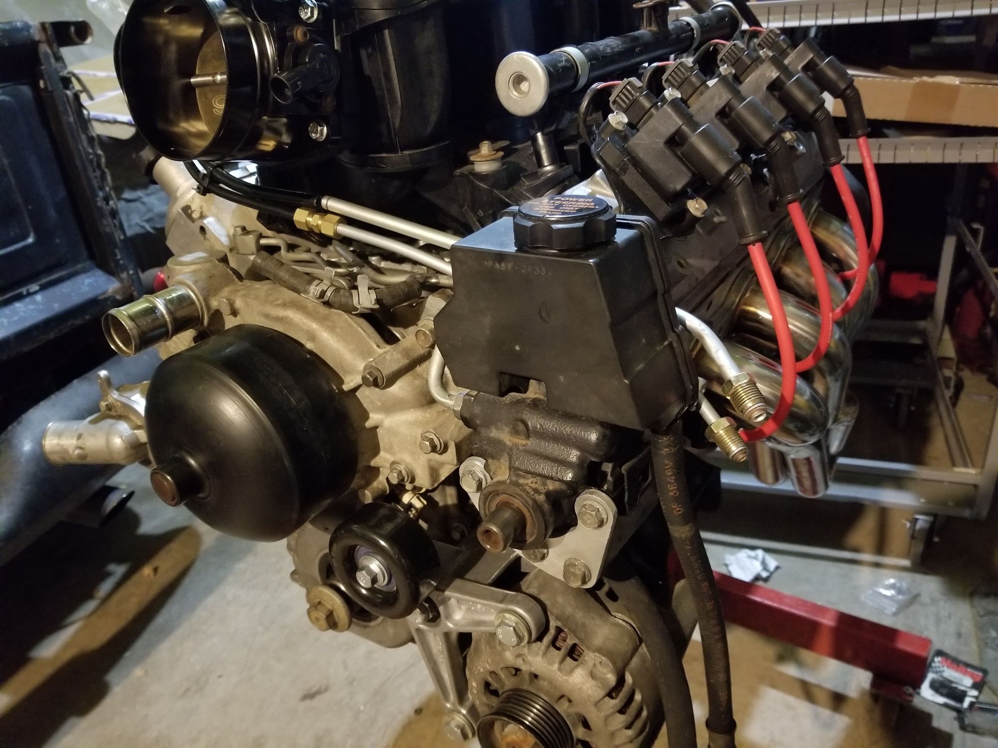

finally got my last shipment of parts from Summit today.
finishing up mocking up some fuel lines to hook up to the stock lines on the engine stand tonight after work, then tomorrow i will start putting the engine together.
is the Terminator X harness long enough to mount the ecu in the stock location under the dash using the stock hole for the TPI harness, or am i looking at drilling a hole for that?
how is access to the rearmost header bolt and sparkplug on the passenger side? i might just put the non AC heater box from my old car on the car and set all the AC stuff on the shelf to go back on later if i decide that i actually need AC.

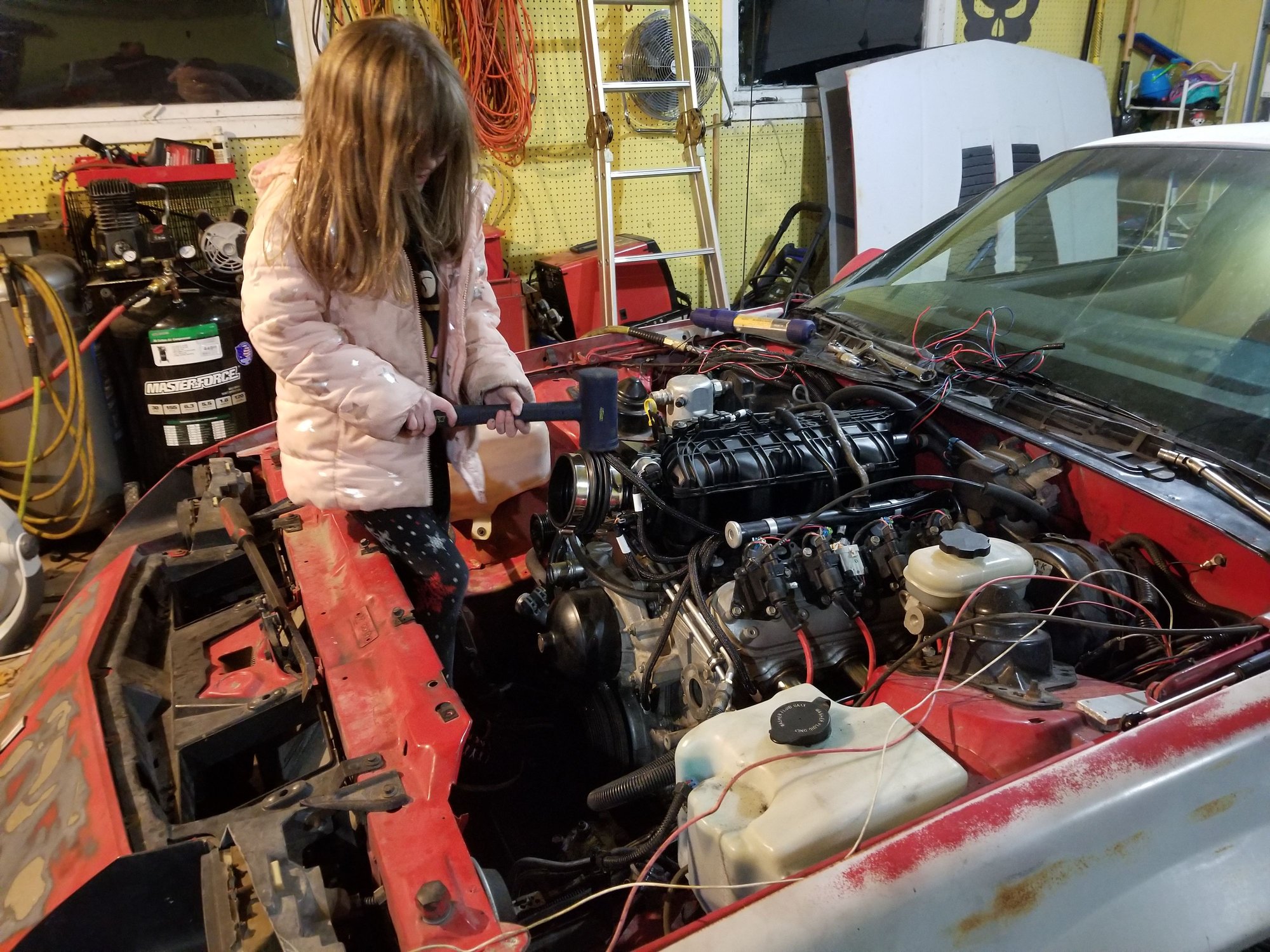

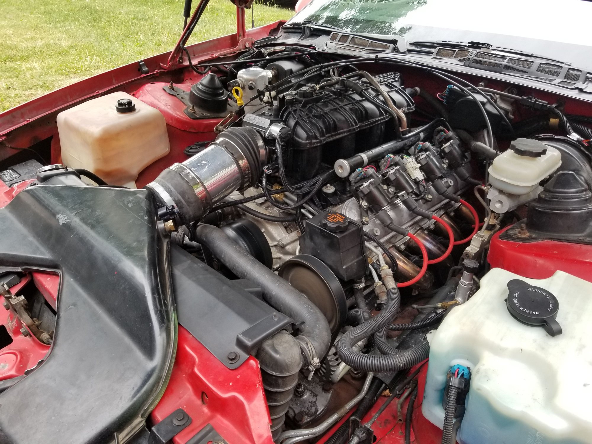

motor is in the car, just hooking stuff up.
-had to clearance the flange on the AC box a bit for the rearmost coil, and still need to finish up a bracket to slighty relocate that coil up and towards the front of the car to clear like i want.
-headers fit nicely, except for the part i had to sawzall off the trans case for clearance. my 5 year old daughter helped install passenger side header by holding the collector up so i could start the rear bolt..
-hood clearance will be an issue, but i had a good helper trying to take care of that for me. she's on it.
-the Holley Terminator wiring fell into place like it was designed for the car. perfect length to put the ecu right where the stocker was. just need to make a pass thru plate that fits the stock hole.
-i wanted to leave the TPI harness intact for use in my girlfriend's 64 C10, but those engineers had other ideas. i had to do some butchery to separate the engine wires from what the car needs going forward. not a great design on their part, but saved some cash at the factory i suppose.
waiting on a couple of oddball things and need to do exhaust and some wiring and plumbing, but should fire up next weekend.

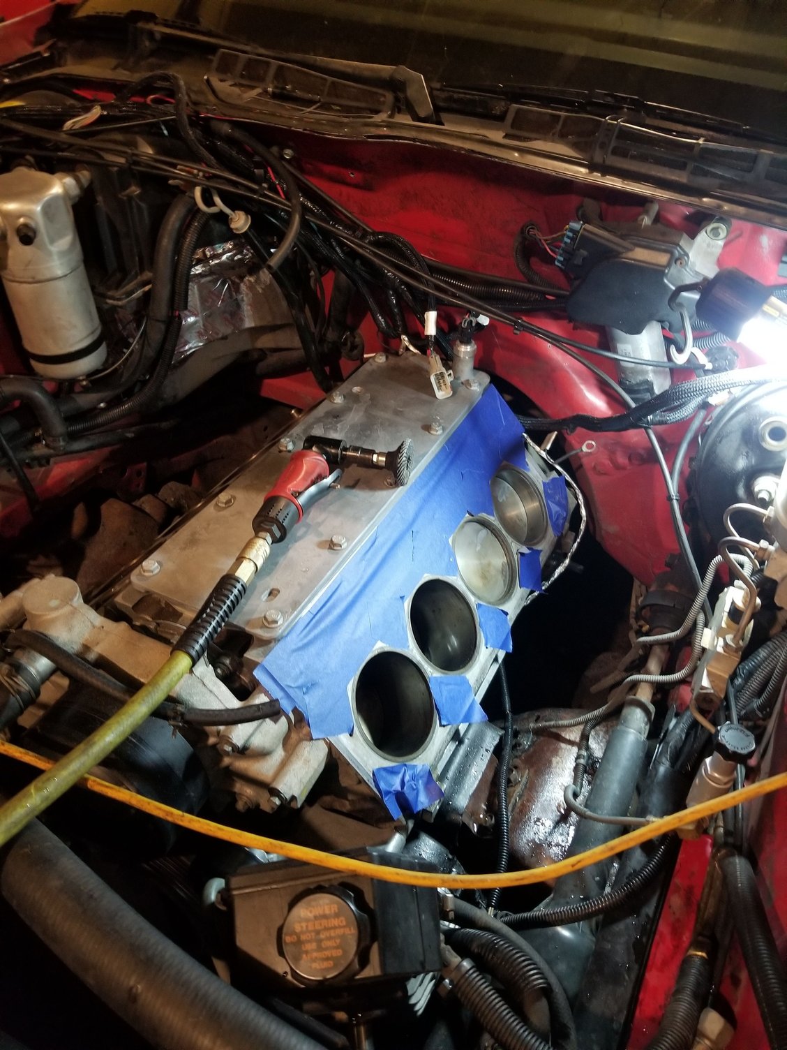

finally got the car going again after taking care of a minor exhaust valve to piston issue in a way that would probably make some of you faint..
getting the efi thing figured out, but the Holley default maps are junk.
just trying to figure out how to get snappy throttle response off idle in gear with a cam that really wants a 3000 stall converter but has a stock 89 IROC converter..
