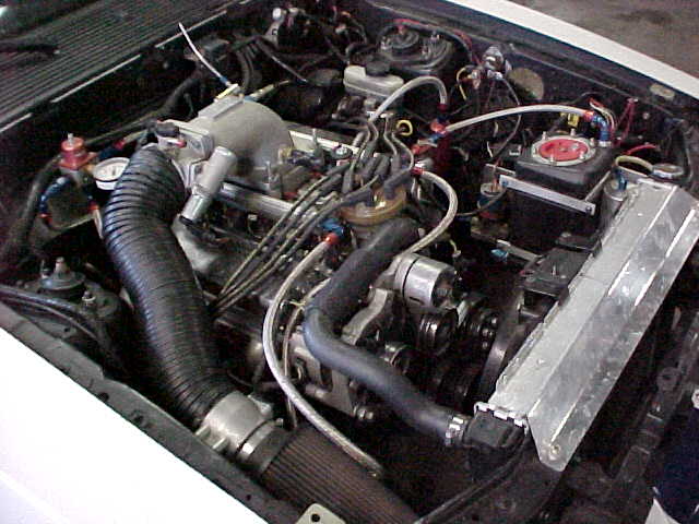

you mean like a chevy version of this?
Old Jul 11, 2004 | 02:08 PM
biggtime's Avatar
Posts: 504
I have one of those already I built,(below) I was wondering if anyone has did it with the long runners and large plenum of the HSR
