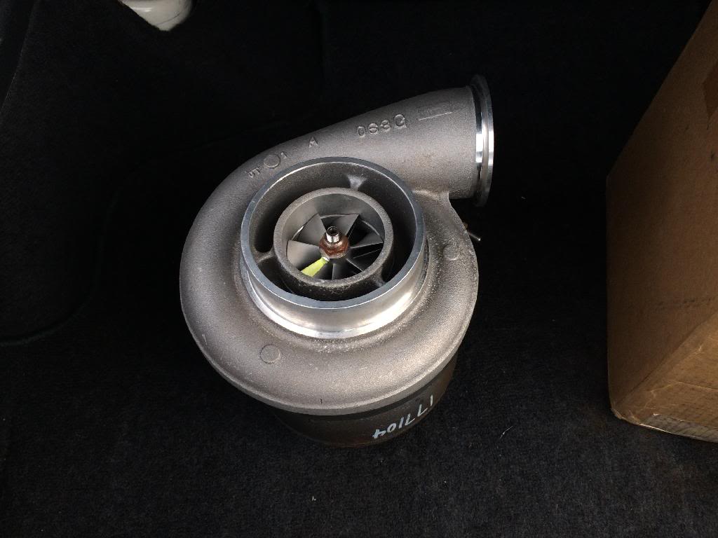

I have an '07 aluminum block 5.3 (L33) with 243 heads. Picked up the engine locally. Story is that it was a dealership pull out due to engine noise, I believe they put a new cam and I believe lifters on it and didn't solve the problem so they gave the guy a new engine. I was planning on doing a simple rebuild on any engine I picked up regardless, so as long as there's no internal damage I should be good to go. I also just picked up a Borg Warner S400SX3 (S471) 71mm T4 1.10 A/R. This is my first turbo build so it'll be a bit of a learning experience as well. I know several people locally that have 5.3/S475 combos and I've seen what they run and how reliable they are so for the most part I'm planning on copying those builds.

Borg Warner S400SX3
