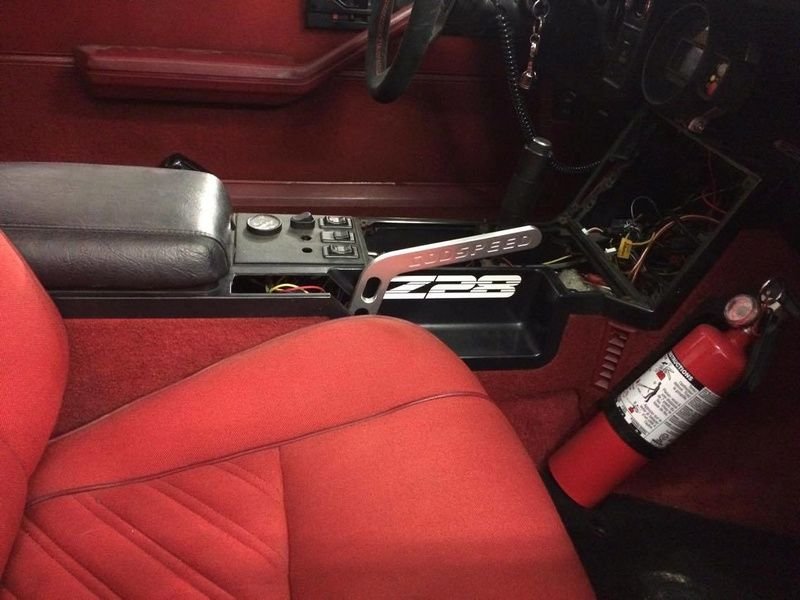

Hi guys, I guess ill bring this post back from the dead. I am in the porcess of building a new chassis to compete in pro-am series in 2017, but I have been drifing a 91 Z28 since early 2013. I will post some pics/videos and some car details here as i get time at work
Attached Thumbnails Drifting a thirdgen: 101-chevy-camaro-drift-front.jpg
