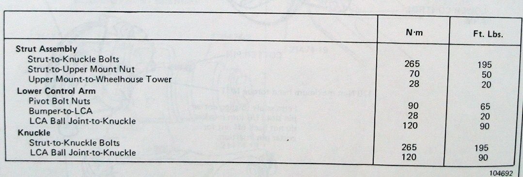

Old Oct 23, 2019 | 01:03 PM
gt4373's Avatar
Joined: Nov 2011
Posts: 2,995
Likes: 354
Transmission: 5-Speed Manual
Re: Front A-arm Question...
Old Oct 23, 2019 | 01:46 PM
