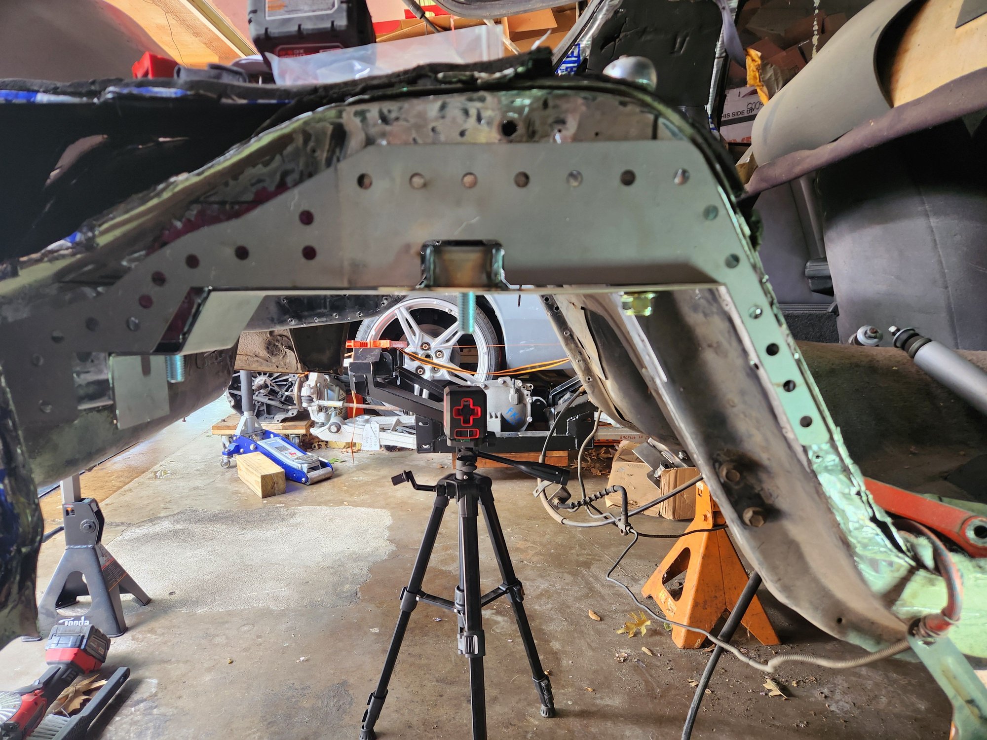

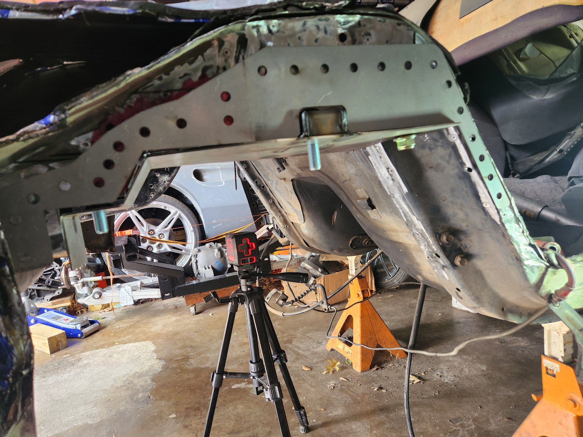

Making some progress making the chassis accept the new subframe

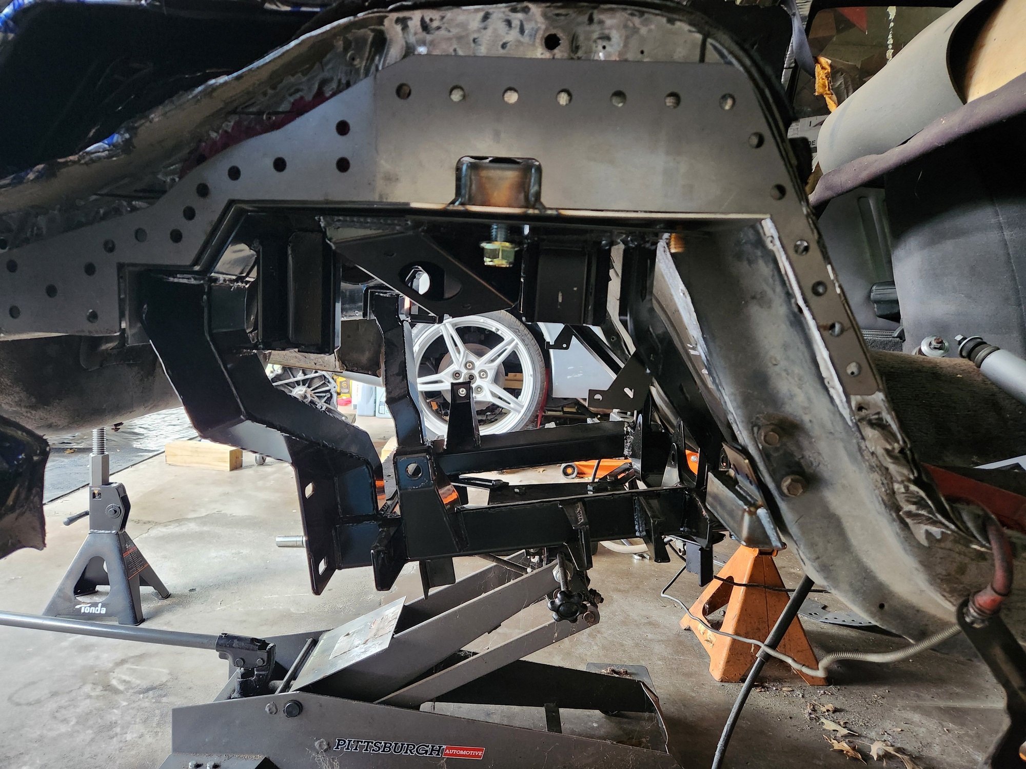

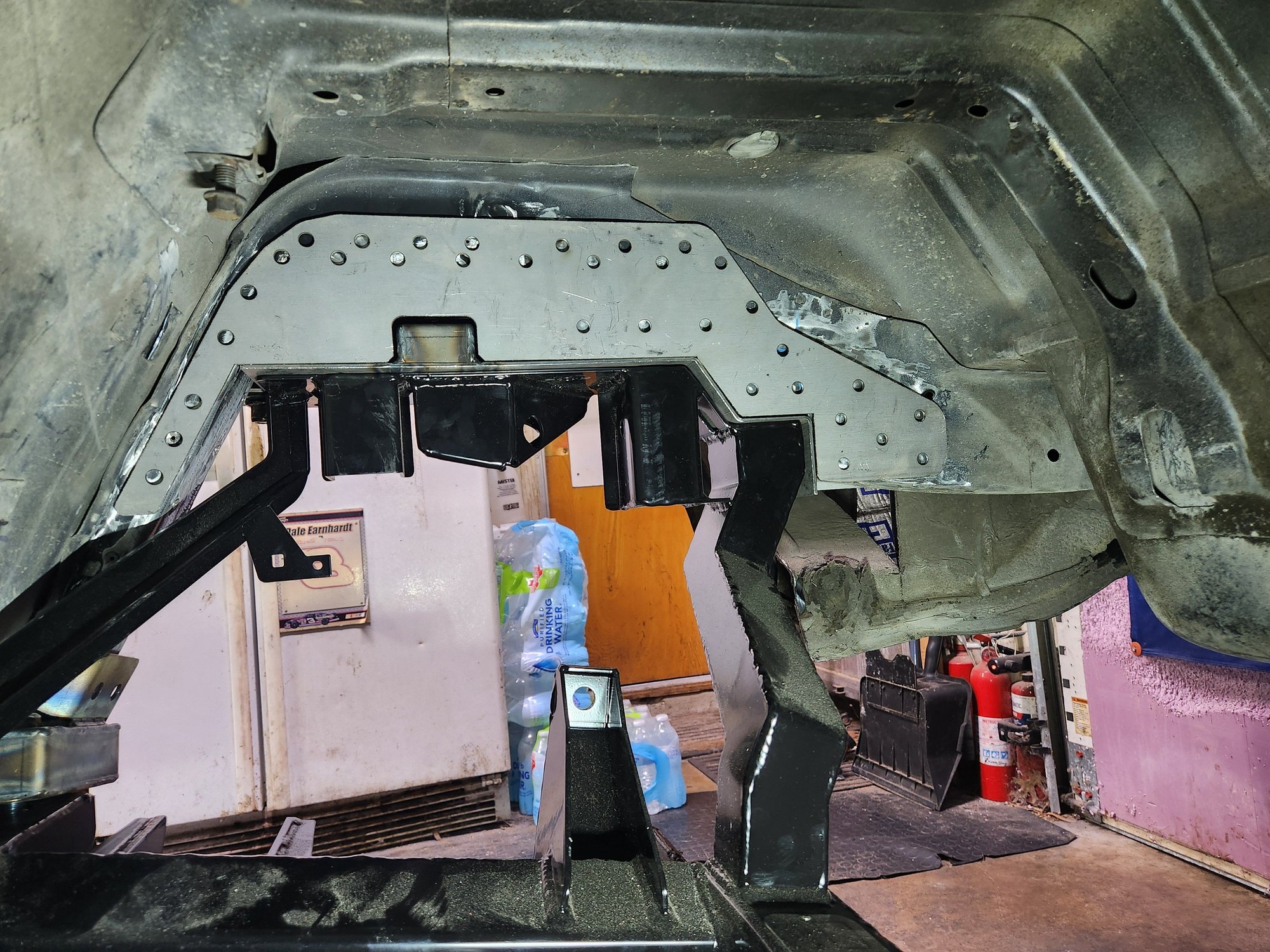

a little more test fitting before committing
to welding it
