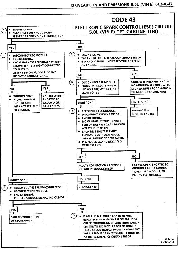

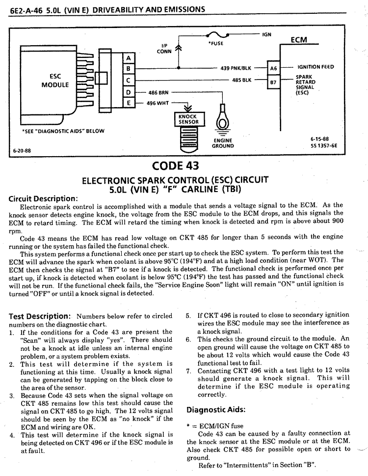

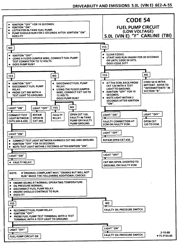

Hello Trans_am_ta_84,
For a TBI engine, code 43 = Electronic Spark Control (ESC) circuit and code 54 = Fuel Pump Circuit (Low Voltage). One other question, after you replaced all these parts. Did you disconnect the battery to clear the trouble codes before you drove it? This info is from the GM service manual and not haynes.

well i'll first say something that i know of.. i don't know what the problem is with the fuel pump relay.. because it doesn't take any longer to start then my friends 305 tbi.. and doesn't take any longer to start then it ever did before. i'm going to try a TPS and if that doesn't work i'm going to make sure all the wires are where their supposed to be..

in the haynes firebird manual code 43 is exactly as you say.. but then there is another haynes odb1 code manual and it says 43 is a TPS. i don't have any idea why the heck code 54 would be coming up. i'll have to waite until tomorrow to see what the TPS is going to do for me.

The reason for that is Haynes tries to cover a lot of model years in their books and they just give the bare basics on a lot of items. For the TBI engines, code 21 & 22 are for the throttle position sensor. 21 is signal voltage high and 22 is signal voltage low.

2 years ago I had troble with code 43. The ECM tries to force a knock to see if the sensor is working. If the ECM cant get a Knock it assumes that the sensor is bad and goes in to limp mode where it backs the timing way off to be safe and gives code 43 SES light. You will lose alot of power in that mode. When you shut off the car it starts over normal till it fails the forced knock test again. I turned off the forced knock test in my chip and have not had the problem since.
