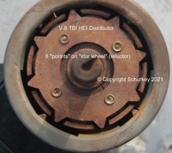

Do you have spark when cranking?
Does the pump prime when the key is turned from "Off" to "Run"?
No spark, no injector pulse, and no fuel pump all point to a distributor or wire harness problem between distributor and ECM. Perhaps a failed pickup coil, or a failed module. If the ECM does not get an RPM signal from the module via the wire harness, it won't pulse the injectors, it won't turn the fuel pump relay on, and you might not have spark.
But the pump should still prime, unless the fuel pump relay circuit is ALSO bad.

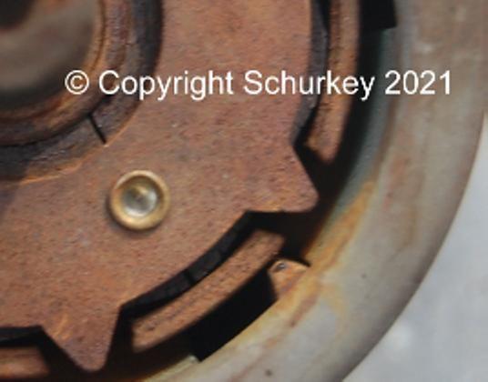

For the record, TBI distributors are notorious for failed magnets near the pickup coil. Causes misfire, or even no-start.
Magnet cracked where riveted.
