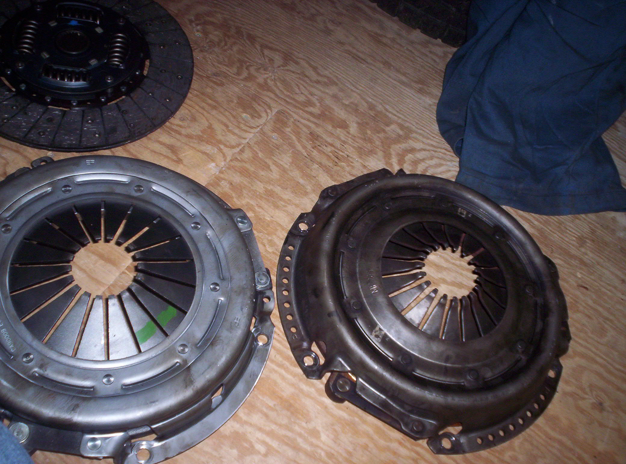

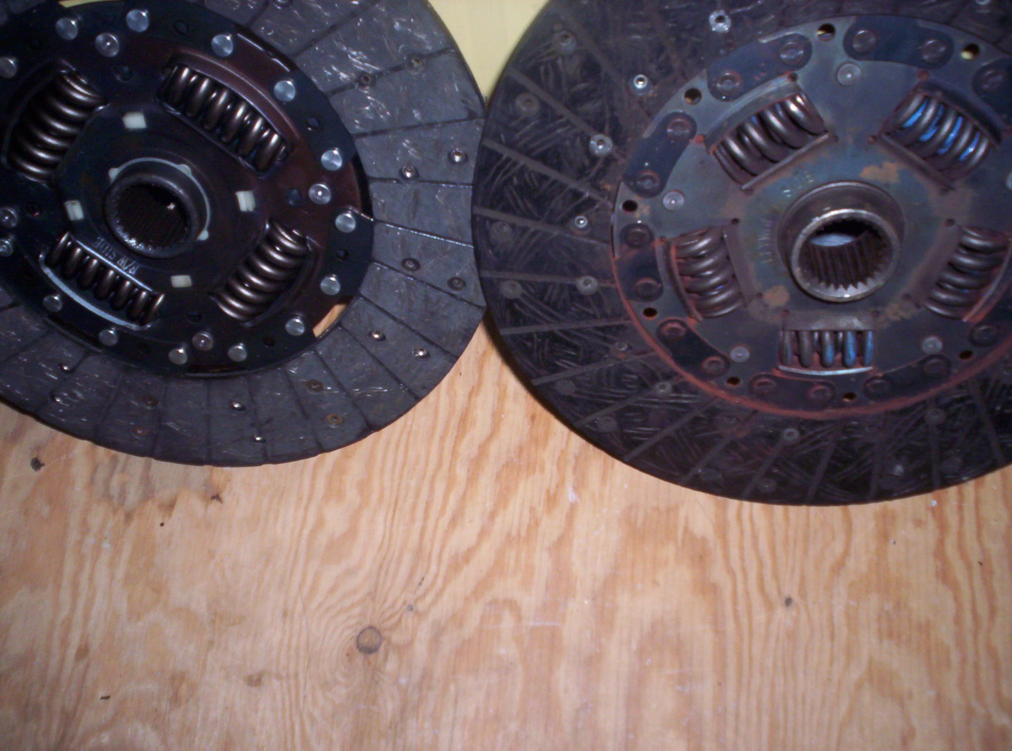

Ok my new slave cylinder that is comming will have a plastic clip holding in the plunger right? do i leave it on and let it break off when i start to bleed it?i'm just headding out now to put the new P plate back in be back i a lil while with a pic of that slave(orange thingy)
Old Nov 3, 2006 | 03:33 PM
Z28er's Avatar
Joined: Apr 2006
Posts: 133
From: Cape Breton N.S
Car: 84 Z28
Engine: 305HO
Transmission: Borg Warner T5
Axle/Gears: 3:73
ok guys,buy the look of my two clutches i definitly have the wrong clutch.heres some pics for yas.on the flywheel side of the clutch disc's,the shaft length on my old one was 17mm and the new one was 10mm,so by my figuring if the shaft is shorter wouldn't take more to pull it off the F wheel?which explains why it wouldn't go into gear.i am so pissed,the guy at the auto parts store if getting a good peice of my mind.in case you want to know it was a Dyna Pacs clutch kit and heres the part # off the box it was in NU0056 or 15-4702-2
Attached Thumbnails clutch problem?-clutch-stuff-003.jpg   clutch problem?-clutch-stuff-006.jpg

that friction plate and pressure plate are something out of an import...but it is odd says it fits all Z28's for 84...
i know weird eh.my buddy got a 92 trans am and ordered the same clutch kit a month ago,his #'s on the box match mine too so its the same clutch.gonna jam the tranny back in this morning with the new C kit and try it with the new slave first.its only 20 min to take the tranny back out so i'll try that.
