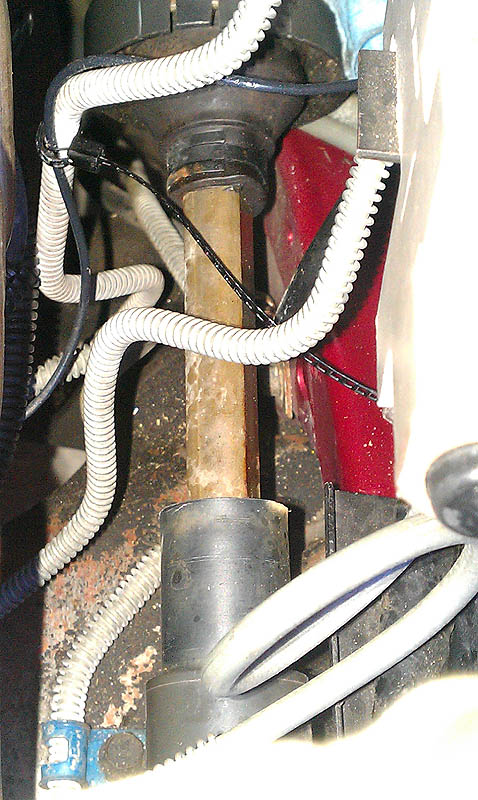

Ok. I tried getting this cable apart and it won't budge. I sprayed WD40 on the connection hoping that it would loosen the seal, but that was a no-go. There isn't much room to play in here as I can only get the wrench in one way and a small pair of vice grips locked on. I then only have about 1/2" of movement if I'm lucky. Even with the vice grips locked on, they want to slip. I thought about just providing enough slack to disconnect it from the speedo, but that isn't working well either. There is a bracket that holds the cable to the "frame", but one of the brake lines covers the bolt and it isn't accessible from underneath!! GM didn't make this easy for me!!!!!

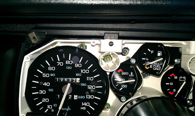

I attached a photo of the bolt that I can't get at and also of the instrument cluster pulled out as far as it will come.
I can get one fingers distance between the white plastic and the mount at the spot just above the turn signal bulb socket. Definitely not enough room to reach in there and disconnect the cable. I read elsewhere that the cable is not accessible from the top if the dash pad is removed. This is not working out very well.

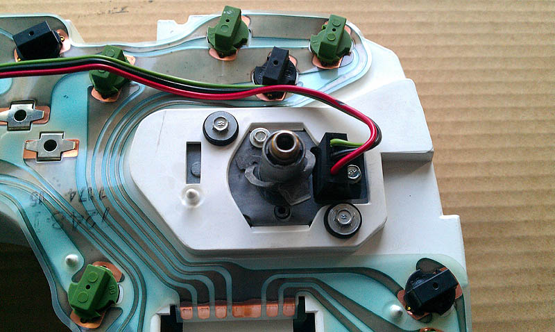

Well, I finally got the instrument cluster out. The spring clip that holds the cluster to the cable is not what I thought. I figured that if I was able to release the connection with a long screwdriver, I wouldn't be able to get it back together. After I put a screwdriver on the clip and pushed, i saw that it opened up the grip on the cable and allowed me to pull the cluster out. I pulled out the inner cable and found that the old grease was thick and gummy. I cleaned it up as best I could and relubed the entire cable before putting it back in the sheeth. Hopefully I put enough grease on it! Connecting the cable to the cluster was as easy as aligning the two and pushing them together.
I did notice with a test drive that the bouncing was 95% gone. Maybe I need to take the bottom half apart at the tranny and do the same thing.
You can see the clip here.

I've had that out too many times to count. Replacing the printed circuit, replacing the dashboard shell, etc... This is the same way I lubricated the top half. I'm still curious about that middle connector neither of us can seem to open up.
