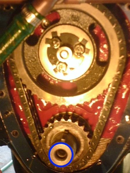

Iirc the pan seal lip on the timing cover hits the block. Bye trimming the timing cover this allows movement needed to put the timing cover back on without dropping the pan.a small dab of rtv is needed soon reassembly.

Here is a tip. When installing the new damper, use anti-seize on the crank snout, and put a little Permatex (about a 1/2" line from the tube) about 1" inside the damper's hub all the way around the inner circumference. The keyway groove in the damper's hub can sometimes leak oil out from behind your crank pulley. The Permatex will roll along as you press the damper on and create a beautiful ring all the way around. You can then use a finger to smooth it a little if you wish.
So, can you explain this business a little better? I can handle putting a little anti-seize on the crank snout. But what Permatex are you talking about? Something special? where is 1/2" from the tube? what about the OD of the new damper? put anything on that, so it can push in and seal against the timing cover seal?

Sure, I can clarify.
A light coat of anti seize on the crank's snout (sticking out of the timing cover, where the 2 woodruff keys are) all the way around.
Squeeze out about a 1/2" long blob of Permatex on the end of your finger.
Apply it to the inside diameter of the damper's hub (end that goes on first) about 1" in all the way around the inner circumference. Your finger will cross the keyway groove.
Light coat of oil on the seal's lips and wipe the outer diameter of the hub (where the seal rides).
Now install with the puller/installer tool. Stop once the hub goes inside the seal to make sure the lips are not folded in.
If OK, continue.
As the damper is pressed on, the Permatex will roll along the inside of the damper's hub, creating a seal so that oil can not follow that keyway groove and leak out from behind your crank pulley.
I prefer the Black Max Oil Resistance Permatex.
Drawn in BLUE on the picture, the Permatex rolls into a bead here.
Attached Thumbnails Crank Pulley seal question.-pass-side-plug-hole
