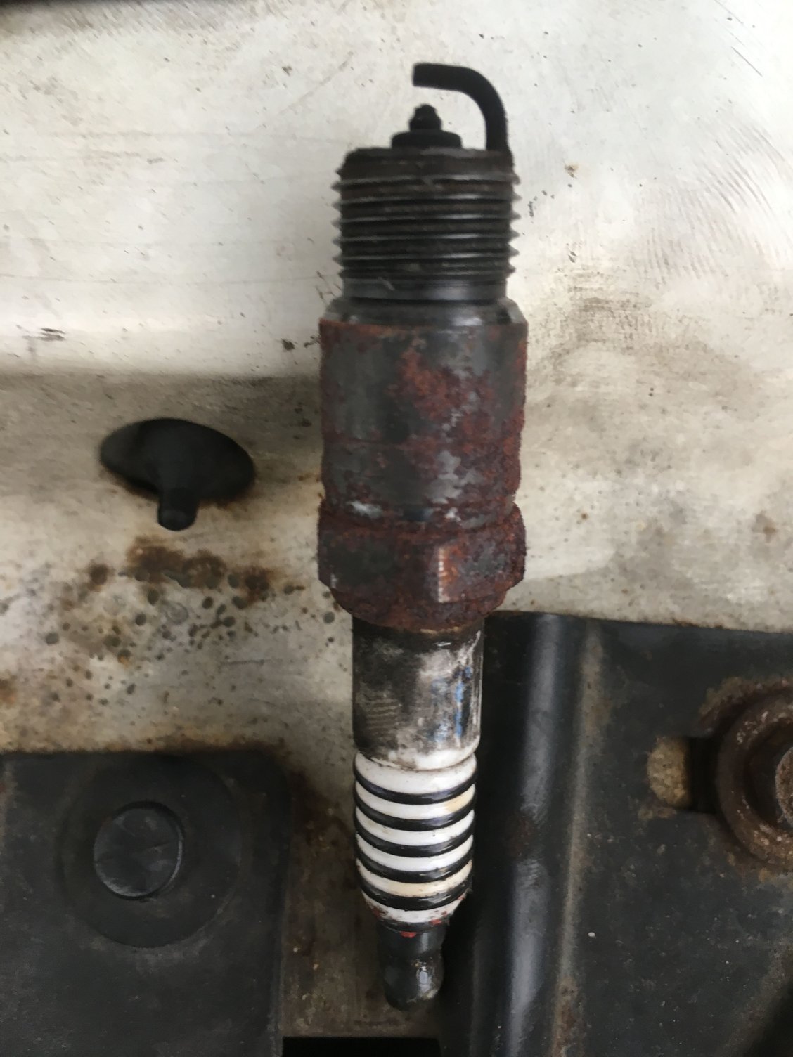

After a long morning at the JY I pulled an unknown distributor cap (Blue w/ Brass Terminals vs Black w/ Steel?) and what appears to be a fairly newer ICM (Model # 0857282B - White in color vs OEM Black?). I also grabbed the Ignition Coil as it's mounting bracket had screws where as my stock unit had rivets preventing me from installing my spare. Stopped for the thermal paste needed and no auto parts store in the city sells it. I was told I could use CPU Thermal Paste and luckily I had some laying around. Installed ICM, New Coil, New Re-man'ed 1228746 w/ AXKT PROM and she fired right up, a lot easier than before also. After a few laps around the block, turned her off and back on with no issues.
However it was too good to be true, Just went outside, tried again... No-Start
*ICM Tested good at local parts store
*Ignition Coil is new
*In-Line Ignition Spark Test Light - Bulb flashes as engine cranks
Just In Case someone thought of asking have I pulled a plug... just did...this is what came out...
Problem with an intermittent is, you have no way of knowing which state it was in when it was "tested".
IOW, it probably was in "start" mode at the moment, rather than "no-start". "Testing" those is famous and renowned for giving false "good" results.
I'd recommend just changing it out.
And some new plugs too... looks like you've got your money's worth out of that one, anyway.

Are you saying replace, the replacement? My original ICM failed in-store testing on the WELLS Machine, the unit I pulled from the yard tested good, and that's what I installed. Before I installed it the in-line ignition spark checker wouldn't flash with the original ICM. It only began flashing with the JY replacement, and that's what led me to the plugs...
