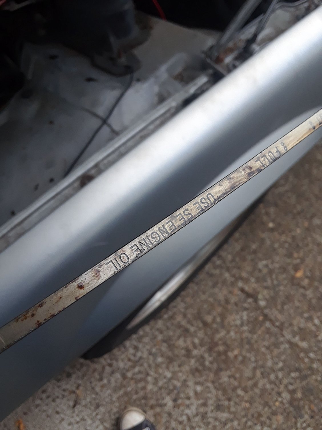

Hi eveveryon. I'm a new camaro owner. IIwasI checchec my oils and noticed there wasn't anything that says what oil to get. I'll attach pics. It's an 86 camaro sports coupe.

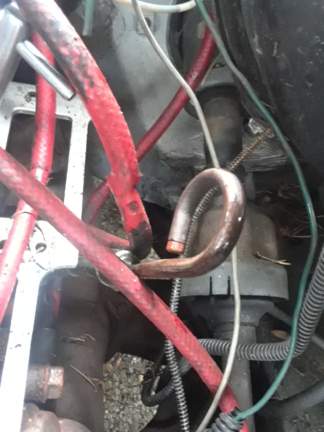

If thats a spark plug wire you might want to start there first...
