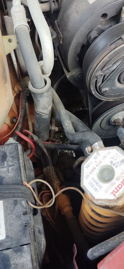

That is the fitting at the bottom of the coolant tank that seems to be the culprit of the leak
A view of the leak. Bunch of wires hanging around. I cleaned them all up today, that one turned out to be the radio memory power wire
another view of the leaking coolant tank
and another...
What is this plug for? It has red and orange wires and its right in between the battery and coolant tank..
And obligatory full pic. A little rough around the edges but it runs awesome and drives smooth.

I tried out the Rheostat for the gauge lights last night and they do work but only in some positions of the Rheostat. The dome light does not work at all I suspect it is just burnt out.
I cleaned the battery terminals and a few of the grounds and it is still starting the same. I think its the issue you brought up where the engine is having to build oil pressure by cranking a time or two first.
I investigated the coolant leak further and I am very certain it is the coolant tank. I plan to replace this as soon as possible. It only has that one coolant line running to it from the overflow correct?
