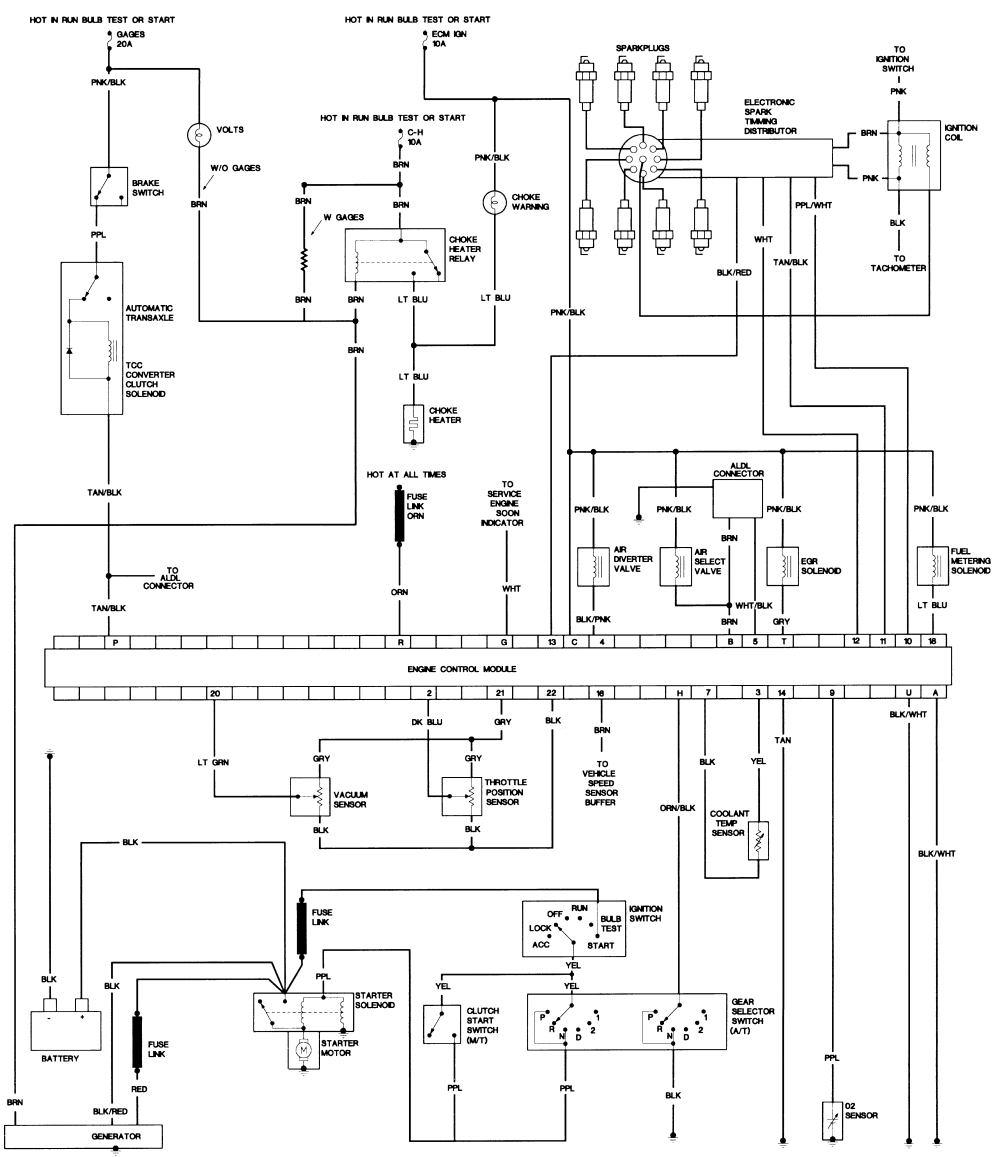

Originally Posted by 82Firebird5.0
....It comes off the red battery cable
ECM
Other half of it should be somewhere nearby
Might have something to do with your Check Engine light
Ok guys I’ve got a mild cam, edelbrock air cleaner, hooker headers and y pipe, advanced cam timing etc
so I extended the factory wiring harness to get the 02 sensor to fit my headers so it’s not an 02 problem. All the vacuum lines not in use are capped off. Any idea what could be causing the light? Which emissions thing should I plug back in to get it to turn off
Don't take this as as scolding , because it isn't .....
You now have at least three threads that I know of in three different areas of the forum all trying to solve the same problem . The problem with posting multiple threads like this is that people who may want to help you might not have noticed the other threads and will be missing crucial bits of the information needed to help you in reaching a proper diagnosis of what's not right with your car . Keeping it all in one thread will give the respondents all the info in one place to be able to formulate the best possible answers .
Now , like Sofa said , I also believe the connection you hold belongs to the fusible link shown powering your ECM in this 1982 CCC schematic I shamelessly pilfered from ATG . Your car's check engine light is driven by a check engine light module that will turn the light on even in the absence of the ECM receiving the 12 volts it needs to run , for that matter you could unplug the ECM entirely and the CEL will still be on , with no signal from the ECM being there to turn it off *.
* Later model cars , like my 1989 for instance , had the CEL module built into the ECM instead of a separate stand alone unit , so this only applies to early cars like your 1982 .
ok I found the wire and plugged it in, car runs much better now. I am worried though I started the car twice and it quit both times because my dumb self had left the paper clip in the ports. Did I hurt anything it kinda ruined my drive when I was worrying about it. Once I pulled it out it started fine
