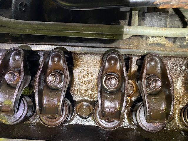

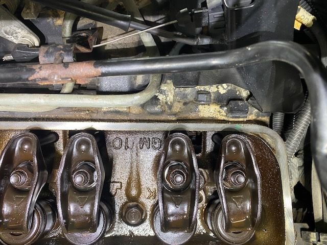

So, I would guess these are stock. They rollers for sure. I ran a camera down there and can see the retainer clips that hold them from spinning. Next and most important question. How much lift can I take these heads with new springs. I have this picked out for a mild cam. Let me know your thoughts on mechanical issues. I just want a street car that you can tell has been cammed a touch. Not looking to rip the tires off the thing. I just don't want to damage anything. Thanks guys.
COMP Cams 08-300-8 - COMP Cams Computer-Controlled Camshafts 262/264 with .450/.480 LSA 112 I have new springs 986-16 springs and retainers with new clips all from comp cams. Will this work in my car without any spring issues or hitting the retainers.
Camshaft, Hydraulic Roller Tappet, Advertised Duration 262/264, Lift .450/.480, Chevy, Small Block, EachCCA-08-300-8

986 will require machine work to the heads.
187 heads are not the heads to do this to.
Get the springs and retainers I linked you to. NOT 986. Not because 986 are "bad" (I've run them myself many a time, on better heads), not because of anything else, other than, YOU HAVE TO SPEND MONEY on those crappy 187 castings, which, at the first possible opportunity, you will THROW IN THE TRASH. And guess what... ALL THAT MONEY you might have spent on that machine work, will GO IN THE TRASH right along with them.
That's part of the "art" side of this hobby. NOT ONLY, getting the most out of what you've already got; BUT ALSO, figuring out how, when what you've got isn't "enough" anymore, how to keep from throwing money you've already spent into the trash.
Do the exhaust work I described - HEADS TO THE STREET - as soon as possible if not sooner. The thing about exhaust is, NOTHING ELSE can do what it's supposed to do, if that doesn't support it FULLY. Think of it as being like your rectum: if it's stopped up, the eyes get dim; the brain gets foggy, the legs get weeeeek, the hands get shaky, ... WHO'S THE BOSS? (Brain, hands, feet, eyes, a$$hole, ???, old fax humor joke, maybe you're too young to remember it) That's EXACTLY the same function that exhaust serves, with respect to a motor. It's how it gets the consumed fuel (food) out of its digestive system.
DO NOT UNDER ANY CIRCUMSTANCES waste unrecoverable money on those heads. Which means, DO NOT do "performance" machine work to them. Which means, you CAN'T use 986 springs on them. Even though, in days gone by, they were the way to go. Butt that was before LSx motors even existed. I think the first motor I put those on, I built in the 70s. Over 40 years ago. I ran a set on one of my own motors well up into the 90s. Butt no more. Times have changed. Parts choices have moved on. New things are available. Hell I'm almost old enough to remember when people threw things at their food as it ran by to get it to slow down long enough that they could take a bite; does that mean a grocery store isn't "A Good Idea" NOW? Of course not. Same kinda deal here.
Use the LS6 springs and the "adapter" retainers. ABSOLUTELY NO MACHINE WORK WHASTOEVER required, just bolt em on. When you realize after whatever else you do and it doesn't have the effect you want, that those 187s are GARBAGE, and you THROW THEM IN THE TRASH where they belong, you can take all that stuff off and re-use it, on WHATEVER heads you get to replace them, and whatever CID short block you put them on. (*cough* 96-2000 L31 *cough*). VERY DIFFERENT from machine work to the castings.
The "300" grind is not a terrific choice for a TBI 305, but will "work". Not as good as the "500" but w/e. I'd recommend sending that "300" back and getting the "500".
