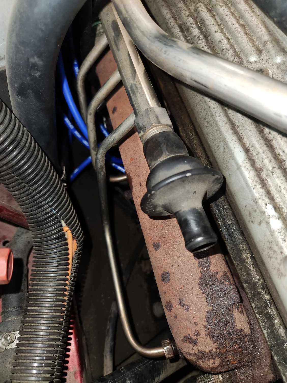

Passenger side
Passenger side
Deivers side
Got the air pump out. These parts have to come out and plugged correct?

They have to be plugged at least. Use flare nut wrenches, penetrating oil, and heat.

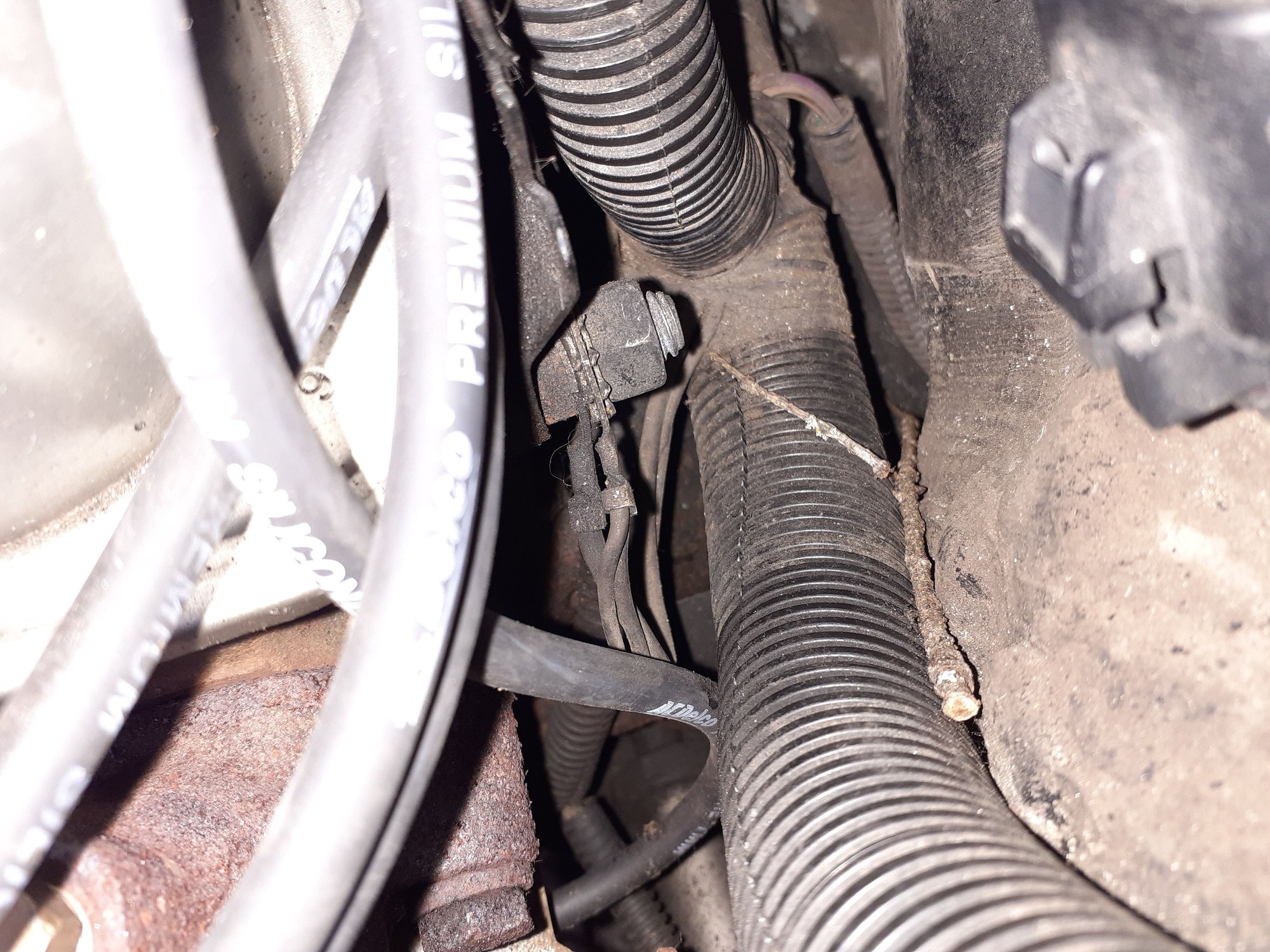

It's tied into the ground nut on the passenger side. I got it with a flex head ratchet and shallow socket. I'm not sure if the profanity helped but I did sprinkle it in there.

Top, it's on the back of the head. This photo is the driver's side but same location on the other side to give you some idea:

Even if you pull that bolt its kinda wedged in there... I think it mightr / will be necessary to pull out the distributor to make it easy....est.....
I gave up and left the pipe in there lol
Remove the pipes from the manifolds and plug them for sure.... it makes spark plug removal SOOOOOOOOOOOOO much easier
