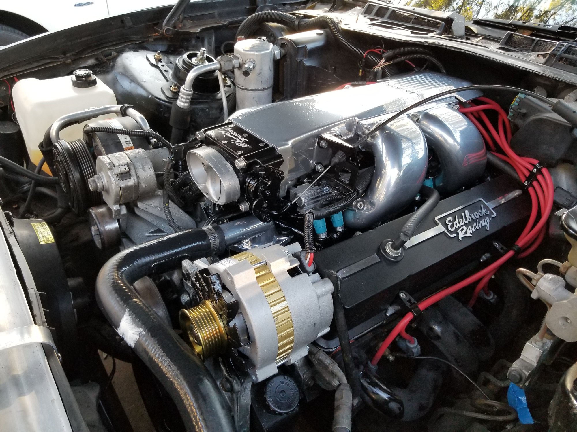

Been a long time member and need some help guys this one has me stumped. I have a 89 formula 350tpi I just installed the fitech ultimate standalone ecu and harness. I removed the factoy ecu and harness. Car runs excellent BUT now immediately after installing this kit the fuel pump will do a 2 second prime everytime I turn on the headlight switch. Fitechs system uses there separate fuel pump relay with 1 wire that I connected to the tan wire with white stripe in the c100 harness.. anyone know what I'm missing here? Fitech was pretty simple and straight foward install im wondering if theres a leftover wire somewhere from the factory ecu harness that needs power or ground idk im lost lol Thanks

Old Sep 18, 2023 | 07:26 AM
meanbird's Avatar
Joined: Apr 2008
Posts: 19
From: Clearwater FL
Car: 89 Formula
Engine: Built 350TPI
Transmission: G force T5
Re: Headlight switch primes fuel pump after fitech install??
