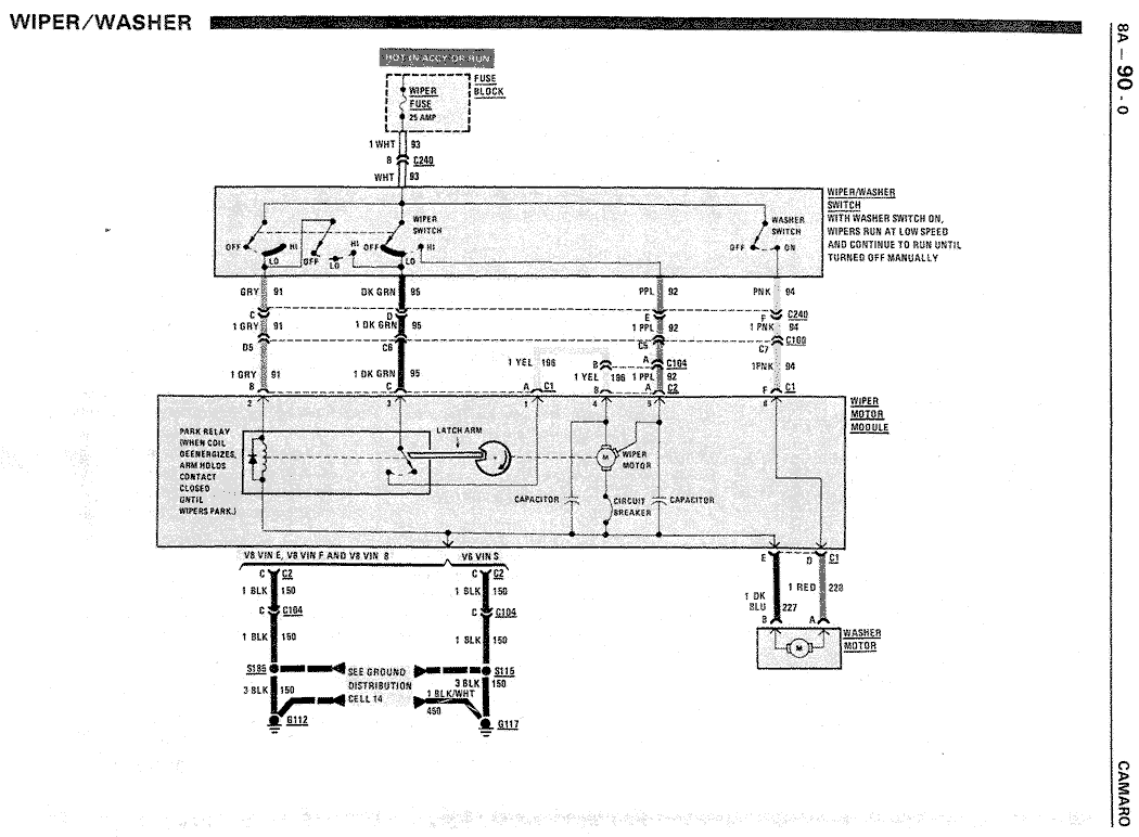

On mine, there is a connector with about 6-7 wires going into the side of the wiper motor. The three wires I am talking about go into the base of the wiper motor and connect by a pigtail to another connector that goes into a large wire bundle along the firewall. Two of these wires (yellow & purple) come back out of the wire bundle and go into the connector at the side of the wiper motor. The black wire is a ground. This is the set-up on my car, your's may just have the two prong connector. Here are some of the schematics I have for it.

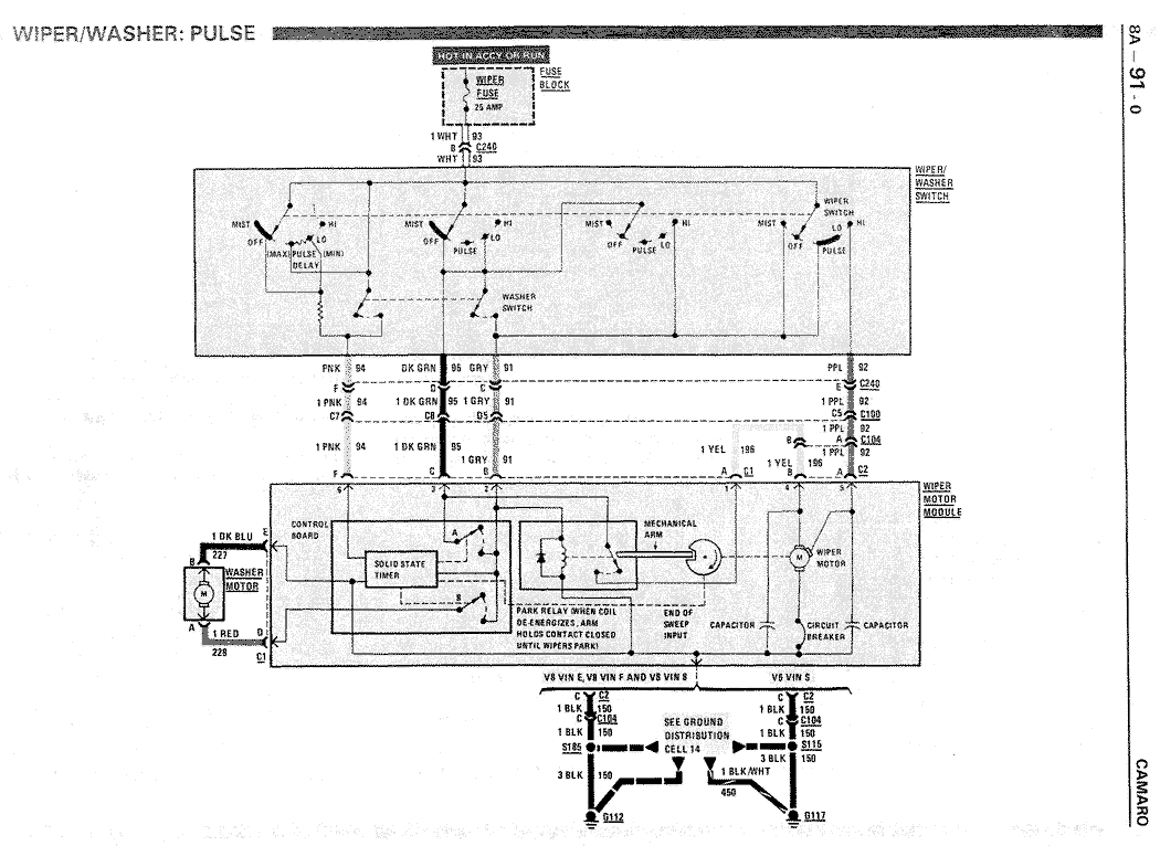

Here is a better schematic of the pulse and standard wiper motor.
PULSE
PULSE
