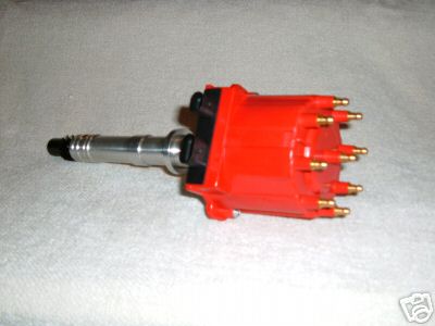

Ok this is like the distributor I have:

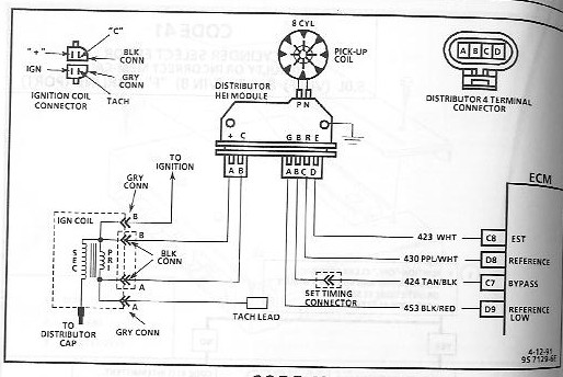

Here's a diagram for a '92. I do not have a shop manual for an earlier mode to help you with the '85 harness.

Great, thanks. Does the '92 distributor use a seperate external coil?
Old May 19, 2005 | 11:33 AM
mystikkal_69's Avatar
Posts: 1,823
From: San Antonio, TX
Car: 1988 IROC-Z
Engine: L98 (350 TPI)
Transmission: MD8 (700 R4) + 3.42 LS1 Rear
yes it does.
