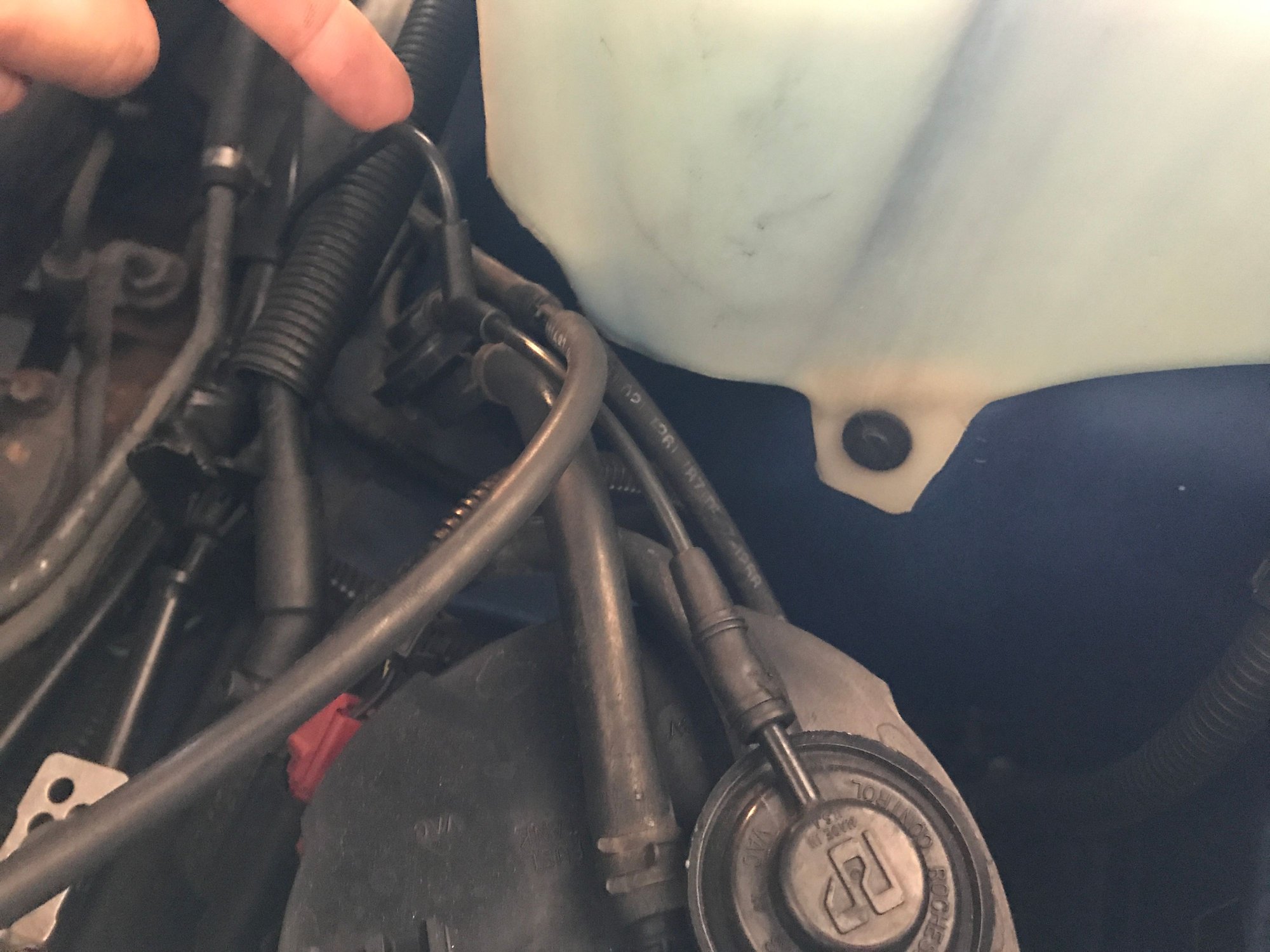

I am proud to report that the idle issue has been resolved! A third-gen buddy of mine found that a hard plastic vacuum line that runs along the right side of the plenum, and then under the throttle body was disconnected from a "T" fitting. Connected it and BOOM, no more codes!
I still have other posts out there with other issues, thank you all for the help
James

Which vacuum line is that? Can you post a picture?

Left side of throttle body
From photo of left side of throttle body to vapor canister
Hard plastic line runs from intake manifold to under runners, to under throttle body and to vapor canister.

Vin there are vacuum lines that run underneath the throttle body that intersect there in a “T”. The “T” is held in place (suspended) under the throttle body by the vacuum lines. It was difficult for me to see that the line was disconnected.
