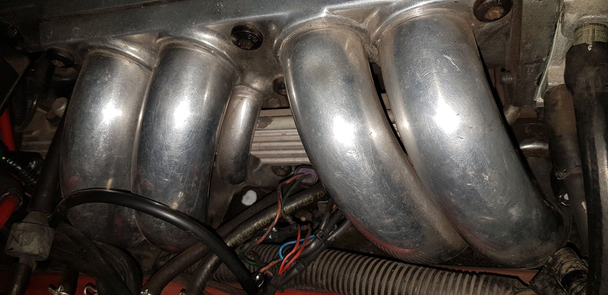

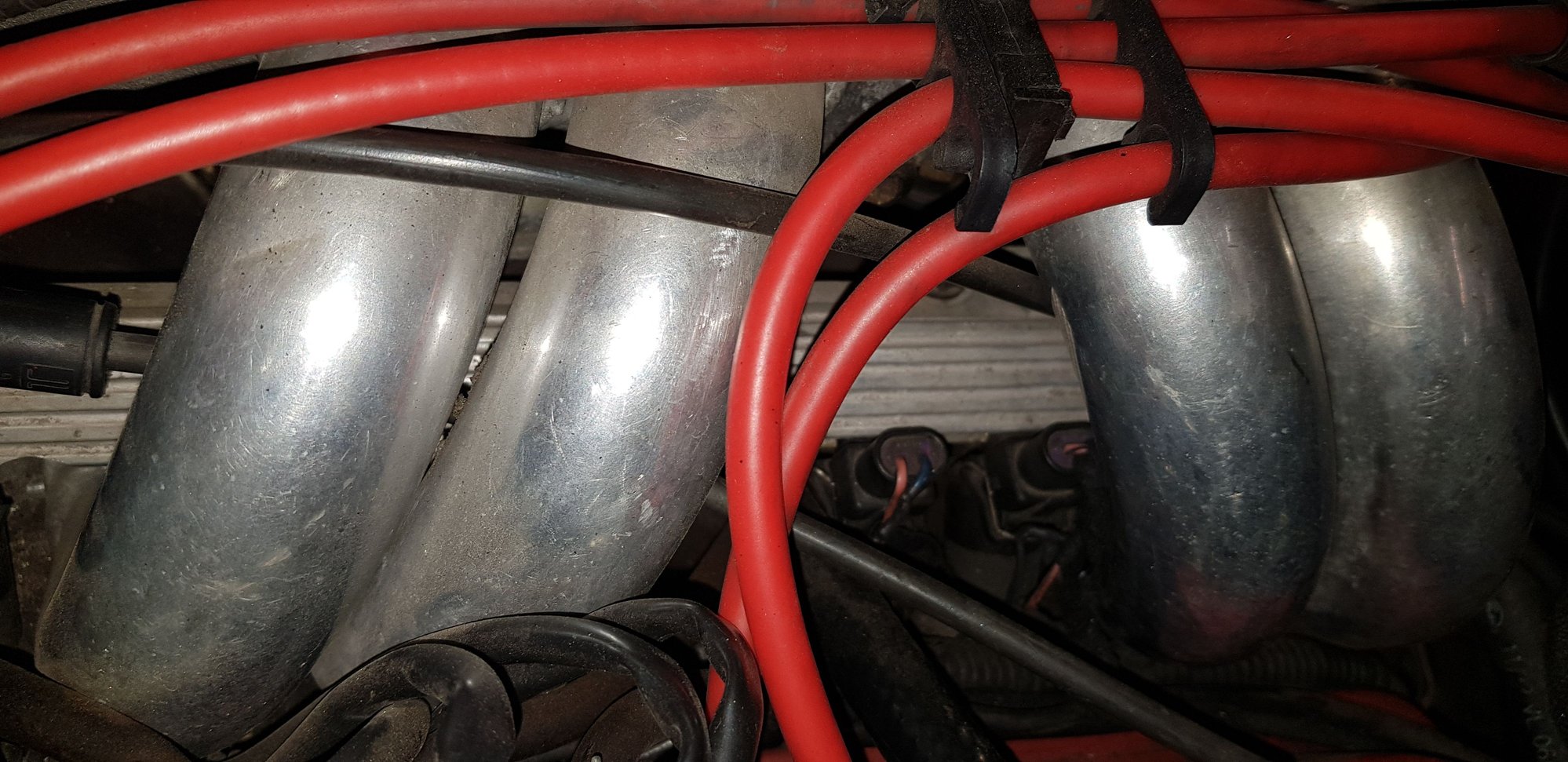

Do you have the correct runners installed for the plenum? Meaning, does it have the small runner between the 2 set of large tubes on the driver side?

I have one on the passanger side.
and none on the driver side
i have just cleaned the old TB (with open iac port) and instaled the same Tps and moved the Bottom IAC assembly to it. And engine is working perfect! I have good rpm and it is not stalling and holding even if i turn the ac and put in in drive. (On the closed IAC port TB it was stalling when cold) So now i am confused what is the problem with closed Iac port ??? What solution to Iac is better? Closed or open?? And what is causing the problem when i install the closed iac TB ?? For sure it is not the IAC and tps (it is set correctly to 0.54). It is strange to me. And thx for Your time and help

As TTOP350 was asking about, looks like you have 89’ up runners and have a 85-88 plenum with 89 up TB which will all work together as is. Your not getting vacuum with the closed off 85-88 TB which is causing the symptoms you were mentioning. TTOP and Tuned pointed me in the right direction when I had a similar issue as I had maxed out IAC readings on my scanner as well.
The closed TB will not work as is but can work if you take a carbide bit and carefully mimic the open design ( near the throttle bores) of the TB that is working. I did this on my car when I upgraded the runners and had a similar issue because the runners were for 89’ up and I had a earlier style plenum like you. Just be careful if you do this as the aluminum is soft and you do not want to go through it. Here is an example of what you are trying for.
