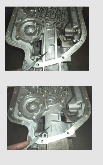

HD:
Normal:

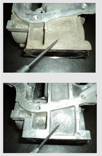

Pan-Rail Difference:
Gear-Section:
Rear of Case and Flange for Tail-Housing:
