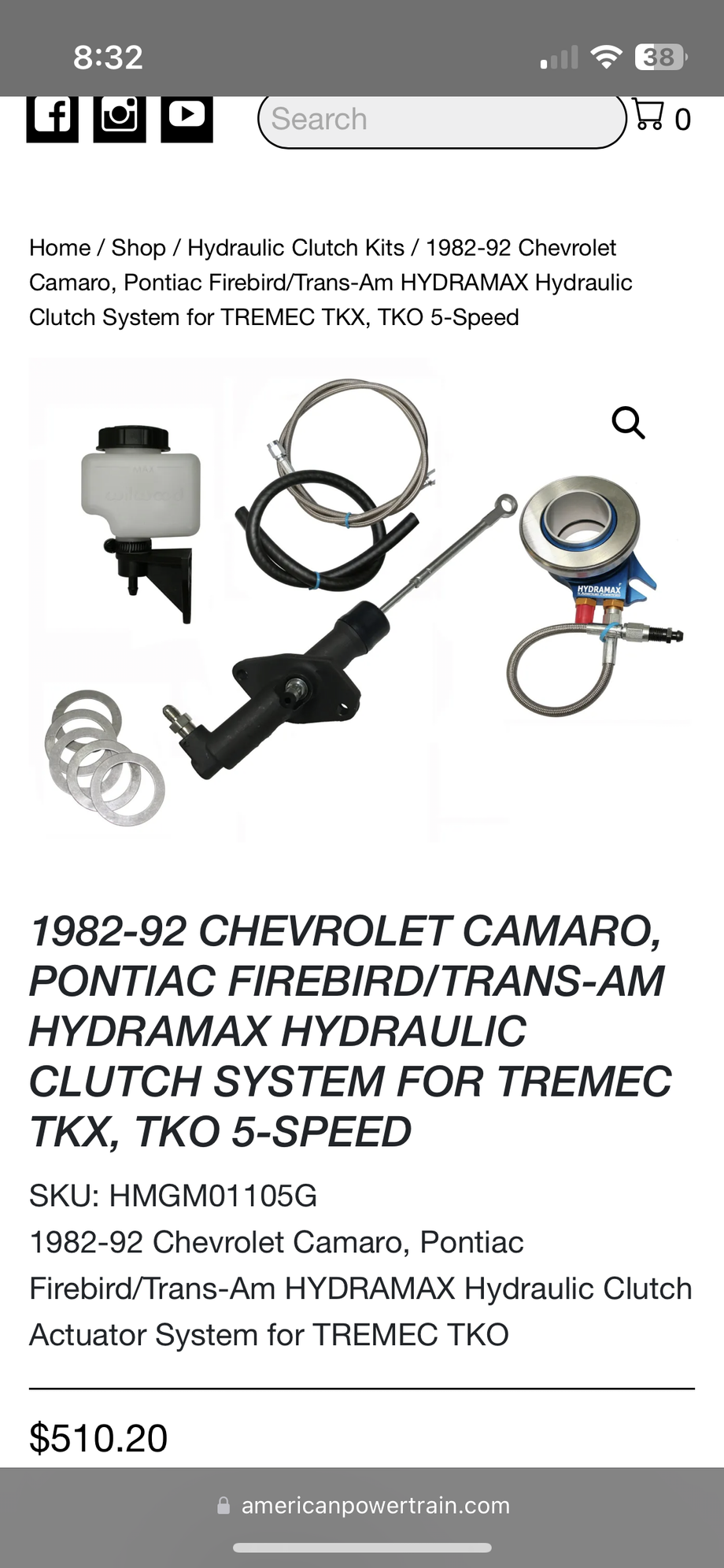

I put the American powertrain hydramax in my 82. It worked awesome. I swapped the pedals from an 84-up and elongated the hole in the fire wall to fit the master cylinder. I swapped to a t56 at the same time but you could make it work w the 4 speed pretty easily.
I have a z bar/all the linkage parts if you wanna just fix it. They're in great shape. That said, the hydraulic setup is great. Any questions you have let me know.

Re: 1982 Z28 Mechanical to Hydrolic
I think this will work with minimal mods. You can likely use your stock bell. The trans it's made for has a similar front to a 4 speed. I'd double check all of it but it should work. I used the version for the t56.

I did the install myself. It was pretty easy. The master cylinder will bolt right in to the firewall w minimal mods and 84 up clutch pedal w no mods. The hydraulic line is standard 3an line/fittings so you can use numerous hydraulic release bearings. The hydramax ones they make will work w your 4 speed. It's not hard to do. I even used a speed bleeder to bleed it all alone and fast. The whole thing was pretty easy just time consuming. I'm sure you can get it to work with minimal issues.
