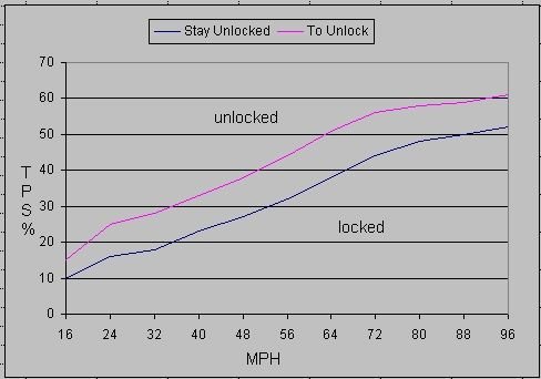

You need a vacuum switch with more hysteresis. Don't know if one is available or not. The reason for the lock/unlock, rinse and repeat is that when the TCC unlocks (low vacuum), the engine RPM goes up which increases the vacuum. This causes the switch to flip and re-lock the TCC.
Then the RPM drops along with the vacuum and the switch again unlocks the TCC. RPM and vacuum go up and the switch locks the TCC.
So need a switch where there is enough 'distance' between the lock and unlock vacuum levels to prevent this. The following graph shows this hysteresis, although in a stock ECM which uses the TPS%. Just replace the TPS% axis with the word vacuum and reverse the TPS% scale, no difference:
