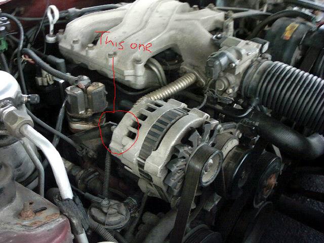

Ok if you have a 90-92 bird or maro, was the best way to change that damn spark plug on the left side, the first one twards the front of the car?

I havn't found any good way yet.
But use an adjustable angle socket wrench, it helps....

Getting the plug is easy. You just need a swivel and a few long extentions. GRAVY. My only problem with that plug is getting the boot on and off. My fingers need to be a little bit longer.
BTW, if you think that plug is hard, don't ever buy an LT1.

The easiest way I have found to get to that spark plug is to just follow the egr pipe down to the exhaust manifold. Unbolt the heat shield and pipe. Then unbolt the metal tube that it attached to the plenum on the side. Pull off the pipe and undo your spark plug. It only takes a few seconds to take that pipe off and it will be LOADS easier than trying weird extensions and swivels. Hope I was some help!

Don't think mine has that metal bracket. Gonna have to take a look myself.
