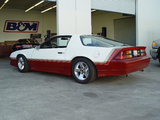

So you know, I am actually an old member around here with 1000's of post, just an new name (Long story)
Anyways, I too live in So Calif (City of Orange)and am going to be putting my 3.4 into my wifescar within about the next year- Its a proven smog inspection passing stealth swap. I need to finish major house projects first then I will finish my motor project. I do know these cars like the back of my hand. Any info you need on suspensions etc, just ask and I can help point you as to whats the best bang for the buck. Most of everything I have done to our 3rd gen is custom 1 of a kind stuff though. Here's a link to it.
https://www.thirdgen.org/techbb2/att...postid=2162232
http://www.cardomain.com/ride/518752/1

Cool looking.. So U know about dealing with cali smog.. I had a 86 Ford Ranger that wouldnt pass smog becouse a code keeped popping up for a tranny problem.. that real problem it was a code for a auto and it was a 5 speed..
