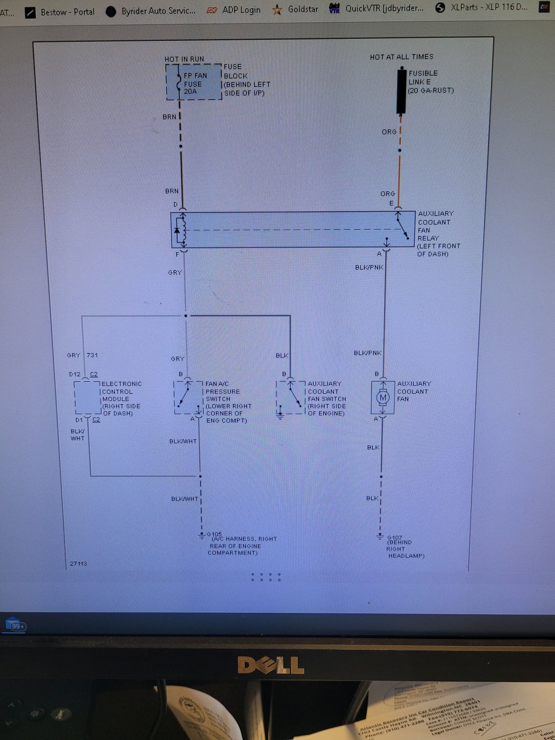

The stock dual cooling fans could be ok if they came on at the same time..... I dont know why GM made them turn on at different temps and what not. id wire them to make them come on at the same time. one fan wil lstay on constantly trying to keep temps "decent" and it will never cool down enough by itself...

I was actually looking this up yesterday if you attached that dark green/white relay control wire to the grey relay control wire it would make both fans work if the auxiliary fan or the main fan is commanded on

I could add that for the duals, fan#1 kicks in around 220°F, ecm controlled and Fan#2 kicks in around 235°F (except when A/C is enable). So they seem to come on quite high IMO, but it's what GM had them at. You can have the ecm tuned to get fan#1 kick in early in conjunction with a 180°F stat and you can change the second fan switch (pax side) to get it to kick in early as well.

I heard GM did that cause the hotter the motors run the better it is for the 80s emission standards?? Something like that.
My car came with the single fan, but I added dual LS fans I just ground the second fan to the PCM controlled fan so they activate at the same time
Works very well.
