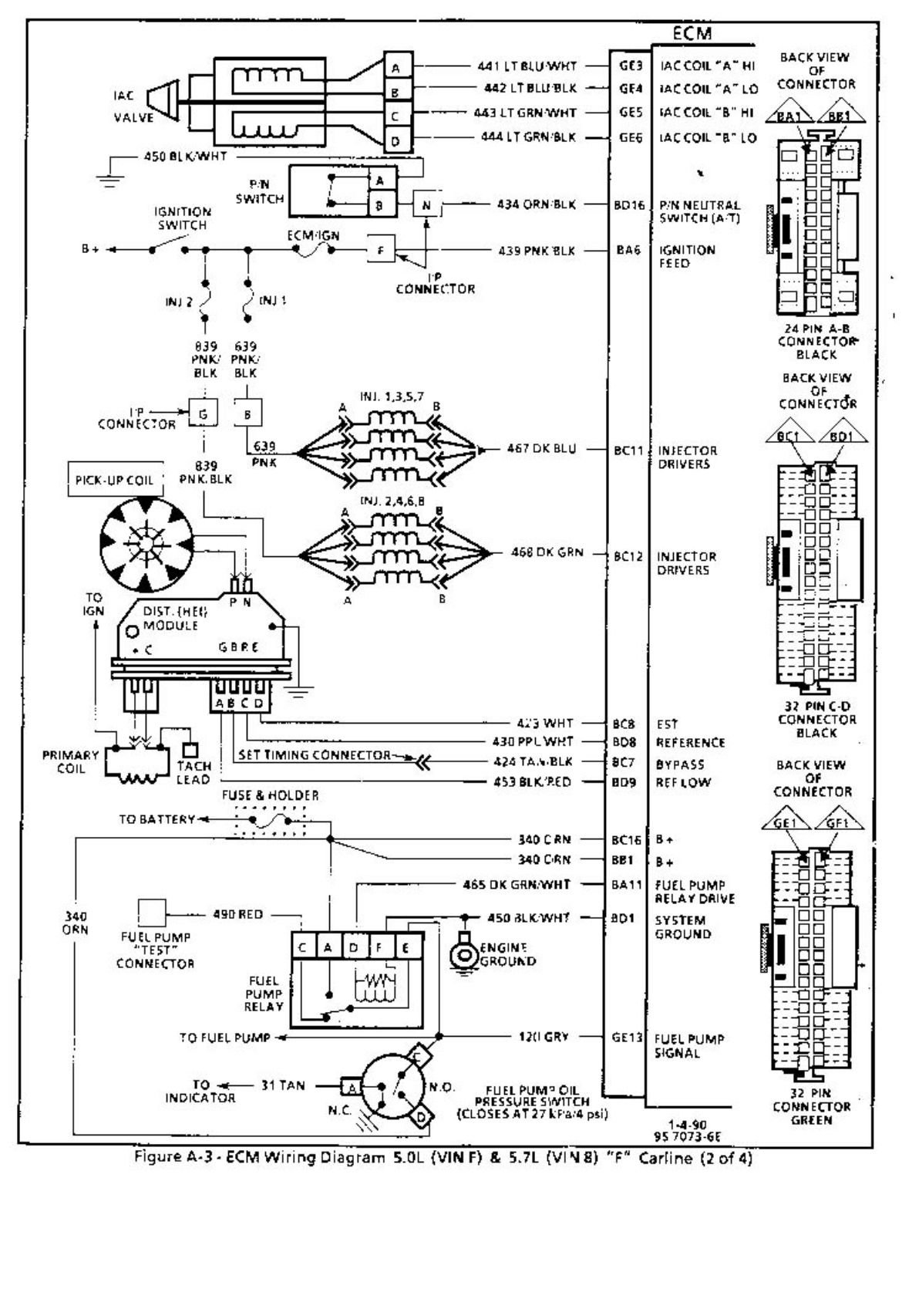

Check fuse next to the battery , here’s the schematic and shows E13

Fuse is good
Have power to the relay
Relay clicks when key is turned on then clicks again a few seconds later
Wont be able to get to the OPS until later in the week

Have power to the orange wire at the relay
No power at the gray wire

Ops is backup for fp relay, follow the code 54 troubleshoot tree

Found the code 54 Troubleshoot Tree
The tests indicate a faulty relay
Relay ordered and will install when it arrives
Big thanks to Tuned Performance
