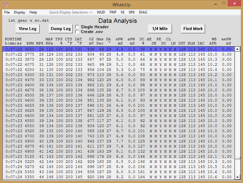

Hello all,
I'm back and started tuning my supercharger for the summer. I've done a bit of cooling system work (3 core aluminum radiator, trans oil cooler, stewart al. water pump) but I think I'm going to need some fans to keep everything cool as the engine stays cool as long as I'm moving and the overheating only happens after extended stop and go driving.
I tune while its at good operating temp and just recently I bumped up my fuel pressure and started some learns. Now that I got the vortech supercharger in I raised my base FP on the 454 tbi with 80" injectors to about 30 psi (according to my liquid gauge). Previously it was at about 25 lbs and my DC was still exceeding the 100's.
Now it starts to jump past 85% after about 4400 RPMs... The DC% is going all the way to 180-190% when the RPMs reach 5500 RPMs... This sounds really bad to me although my AFR is at 10.0 reading from the WB.
Now that its VRFPR I find it funny that the DC is going so high...when the engine was N/A with 18lbs static fuel pressure it would not go past 100% ... will a SC really bump things up this much or could the default boost parameters in my tune just be over compensating with too much fuel now that it sees boost due to the 2bar map? ... guess this would also explain the 10.0 AFR.
I uploaded a datalog screenshot... and ideas?
Thank you!

Re: Tuning with the EBL
The WB should be very accurate assuiming it was calibrated. Does the WB show realistic numbers under light load(cruise)? If so I bet it is accurrate.
You bring up a good question on the DC% reported. I wonder if it is showing accurrate or did you provide eroneous info in the tune making it report high. I know RBob prvides a calculator in Utility for BPC vs VAC. I would consider using a Mighty Vac and get the real numbers. Once over 0VAC I would think you need to bring in + pressure with another devise. I plan on doing just that this summer. I have an Aeromotive 13301 VAFPR.
you might have something funky going on with your NBO2 setup. look at the "O2 mv", there are some data points where you'll find it at .6xx or one even at .430 volts, which imho could be the culprit to make the commanded AFR and hence the DC that much higher. if i'm not mistaken these ecms, when in OL for WOT, will check O2 voltage and it shouldn't be any leaner than say 0.9V or whatever the set limit is, otherwise it will add fuel.
you can also dump that log to csv or excel and look at the "AFR" column, which displays the commanded AFR. i would suspect that this would be much higher after the lean voltages occur at the NB O2.
edit: just more of a routine question, but you did enable the right bits for the 2 bar MAP, and not 3 bar? and also might wanna recheck if all the BPC tables are correct for boost, and maybe BST tables. haven't messed with these yet tho.

That may be an issue as well. EBL not reporting real A/f. My WB does not report to EBL. It goes onto Innovate controller memory or shows on pillar gauge updating ever .5 sec or so.
I have 75 lbs inj(aka 80) at 21 lbs FP and show 85% DC in EBL in PE (12.8)being NA. I can see boost needing a lot more. I read recently fuel demand could double for large blowers.

Once the injectors are at 100% DC they are open all of the time. The DC is a calculated value based on RPM and the injector PW.
With the AFR being so low you need to reduce the values in the boost fuel multiplier table. This will also lower the injector duty cycle. But that still needs to be in the 85% area.
Note that you can put negative values in the boost fuel multiplier table. This is sometimes required with systems that are as efficient.
The BLM at 113 isn't helping either. As when inn PE mode it is lower then 128, 128 is used.
RBob.
RBob.

Ronny:
The WB values look pretty decent at Light load and cruise... I did some WB VE learns and they are starting to look much better although DC is still exceeding 100%.
I used the calculator Rbob provided me with to calculate those values (Vac Ref for 0-100map and non vac ref past 100map due to the boost). My values are actually a bit higher than the calculator recommends ... about a 30point difference. The calculator recommends a min of 78 & max of 108. My min is at 113 and my max is 143... I heard this aint much of a big deal since these are used as reference values but could be wrong?
I have the same Aeromotive as you too!
Ownor:
I noticed that too but I remember that on that run my tbi stopped to chug a bit in the middle of the WOT run...bad example to post. I dont know why but could have been because the tune was really off since I didnt do any WB learns after adjusting the FP so hopefully thats where that hickup came from. I'm going to try that excel spreedsheet thing... I didnt know there was more info behind what the EBL analysis showed... thats pretty cool!
Double checked just now... I have the "Option Word 2 - Bit 3 - 2-Bar" checked off and the 3bar option right above it is unchecked.
Ronny:
I do have the WB TT1 controller and what I like to do is plug that into my laptop first before I plug the EBL in to make sure its working by itself... then once I verify that the WB AFR needle is moving around on the TT1 software around I plug the EBL in... I have the EBL getting the WB info from the com port its setup on.
Hopefully boost doesnt make me switch injection systems :/
RBob:
I really hope thats where the answer is at... I noticed those boost PW tables are pretty high with values near 13-16% where I'm starting to see the extreme DC's. This would make sence since the boost SA tables were so dramatic that the car felt completely powerless as these tables were taking 10 degrees of SA when seeing boost. They must have really wanted to make sure someone didnt blow up their engine with these pretunes lol. If these values really mean that the PW is being increased by 16% then I'd be pretty convinced that this boost tables could be the culprit... hopefully!
I'll try to decrease those a bit and see what the DC's start doing.
Here's a few more screenshots of what things look like after decreasing the FP back down to 24psi and running some WB VE learns. (Couldnt stand the strong fuel smell with the FP near 30) The learns seemed to have bumped the AFR to something a lil more reasonable.
Now that I think about it... I think I'm going to be OK as far as my setup goes... correct me if I'm wrong but if I was truly running out of fuel then wouldnt by AFR be leaning out? Instead its too rich?
Thanks for all the help everyone!!
I see you have plenty of fuel with a Walbro 255. You really need to crank up the fuel pressure.
How is it you are only at 190-199 grams/sec on airflow?
Is that max the EBL can measure?
I guess not. I just pulled a datalog done this AM. I was at 229 Gms/sec at 4900 rpms 100% TPS 90 MAP 91 MPH. And I dont have a blower?

Well I think it comes back to that DC value being only a "calculated" rather than a realistically calculated value but im not sure...
The FP is at about 25 base so it should be jumping up higher under boost at a 1:1 ratio
as far as the grams/sec values go... What do these mean and what are they calculated from ?
Once at or over 100% the injector is always open.
I agree with Ronnie, more fuel pressure is required. Looks like about 6 - 7 psi and the AFR is at 12.3 - 12.6. With the DC over 100%, there is no headroom to get the DC at 85%.
The gms/sec is not used in the fueling other then for the INTegrator and proportional gains logic. Which is why it is in the analysis displays. That value is required to get the proportional gains dialed in.
Note that once in boost the VRFPR just keeps the same injector flow rate, no increase. This is due to it being a blow through set up.
RBob.
IOW if you see 150 MAP kpa maximum then you up fuel pressure and adjust BPC(downward) to show 85% DC at that RPM/MAP ? If so would not the idle be an issue?
